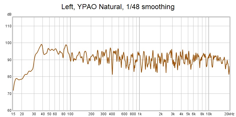

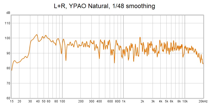

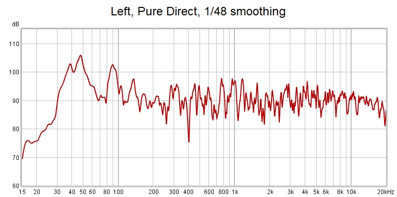

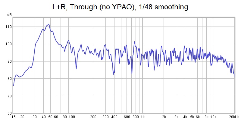

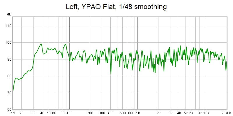

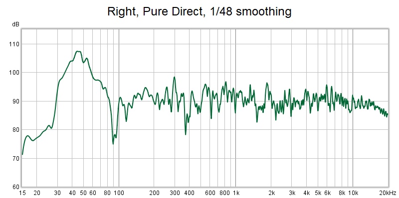

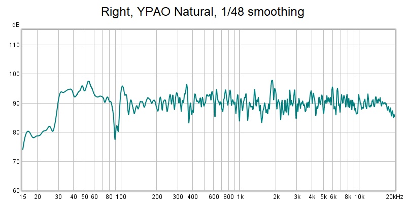

Ok, I took a bunch of measurements. Below two graphs:
Left speaker
Right speaker

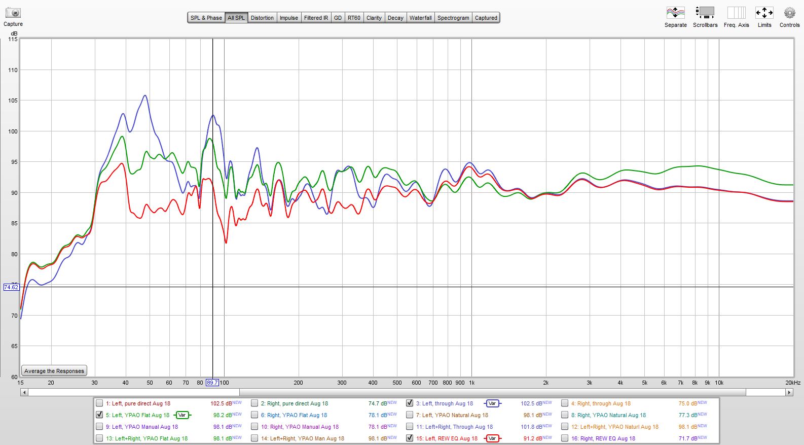

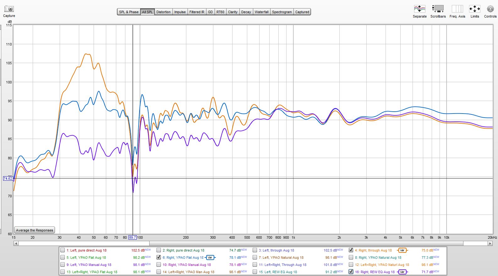

Overall conclusion, the way YPAO applies filters gives a pretty decently flat response. For the left speaker it removes a spike around 50hz, which gives an overall flatter response. For the right speaker, which is in a corner, it again removes the huge peak between 30hz and 60hz, and is able to flatten it a bit. The right speaker does have huge dip at 90hz, and that'll probably only be solvable with positioning and treatment. It can technically be EQed, but it would probably cause distortion/clipping as it would need to really up the gain around that frequency.
I generated some EQ filters in REW but none of those lined up with what I can set in the Yamaha. I had to manually enter Freq values and had REW optimize the Gain and Q. Results not that great, or at least, not any better than what YPAO did.
So overall, YPAO does a pretty decent job. Not sure if Dirac or Audyssey would improve on this much. Thoughts?
The response looks like +/- 2.5dB from 100Hz-20kHz, which is great. I doubt anything will do better.
