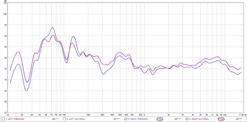

I took some measurements also with my A2070. I think YPAO is doing a good job on the Left speaker, not so sure about the Right one.

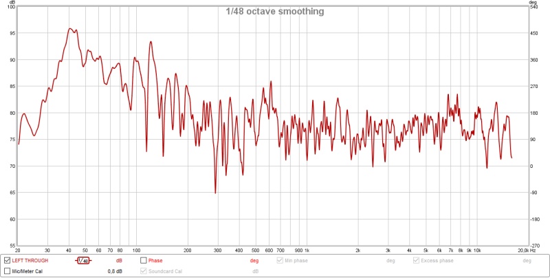

1. LEFT THROUGH (no YPAO)

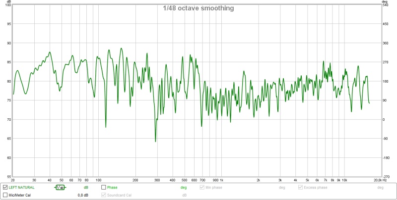

2. LEFT NATURAL

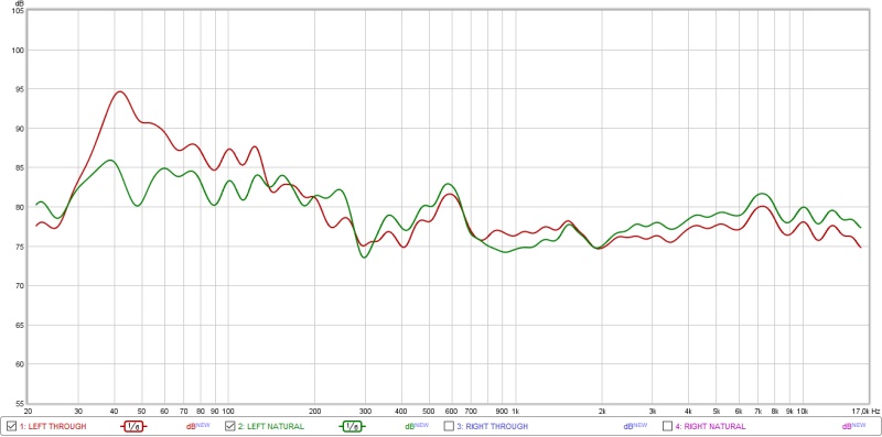

3. Comparison LEFT (1/6 smoothing)

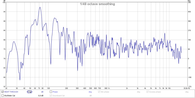

4. RIGHT THROUGH (no YPAO)

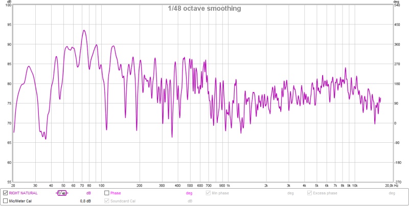

5. RIGHT NATURAL
6. Comparison RIGHT (1/6 smoothing)
Any thoughts? Good enough?

I think THROUGH is about +/-3dB, NATURAL is about +/-3.5dB from about 380Hz-12kHz.
What speakers do you have?

It would be easier to comment if we have the following info:
- Speaker and subwoofer (if used) models
- Graphs for stereo, both channels playing during the sweep
- Crossover point if subs are used
If YPAO is as good as XT32, it should try and integrate everything in the bass region so that the phase (time domain) are taken into account for good overall balance as most speaker don't listen to one speaker only even in mono. So if your graphs show the right speaker not as good, it could be due to YPAO compromising to improve the overall bass response. Most people don't listen to mono using just one speaker.
Yours certainly don't look as good as sakete's, and someone like @AcuDefTechGuy may not like YPAO on if he's in that room because he doesn't seem to like accurate/flat FR in the low range, so he may prefer yours to sakete.
Looking at the mid and high range, it would appear sakete has much more neutral FR than yours. If I got it right, he has the Revel F206 that has very flat response to begin with, and his room may or may not be as challenging as yours too and that is another big factor.
The FR below for the F206 obviously look smoother than most people's in room response as they were measured in NRC's anechoic chamer.

Thanks guys. My speakers are Focal Aria 948 which deliver plenty of bass
Measurements have been taken with them as Large (no sub x-over) but in real life I set them to small (x-over at 40hz)
So you say I should measure a stereo sweep to see how all is integrated instead of taking individual measurements?

Yes, would like to see the sweeps for the following:
1. Stereo left+right direct with no YPAO, large, no sub. Straight/Pure direct may take care of that.
2. Stereo left+right small+subwoofer, XO 80 Hz
3. Stereo left+right small+subwoofer, XO 90 Hz
4. Stereo left+right small+subwoofer, XO 60 Hz
The Focal is comparable to the F206, but it likely have deeper bass that will mess around more with the subwoofer so I expect the graph for L+R+Sub will look the best if XO is set to 80 Hz or 90 Hz.

So, charts using THROUGH:
1. Through, no Sub (Large)
2. Through, XO 80hz
3. Through, XO 90hz
4. Through, XO 60hz
1b NATURAL large (no sub)
2b NATURAL, XO 80hz
3b NATURAL, XO 90hz
4b NATURAL XO 60hz
It is difficult with so many charts. I think the best curve is 3B
@sakete yes, UMIK is in the same position as YPAO mic. And yes, the Focal 948 present Mids a bit recessed. I have solved this by rising 315-396 frequencies in YPAO manual
sakete
@Deckard71 it's weird that in natural full range there's a weird spike in the 600hz range, that disappears when crossovers are enabled.
@PENG could that be some sort of resonant peak?

Could be that your subs are compensating where your speakers could not.
