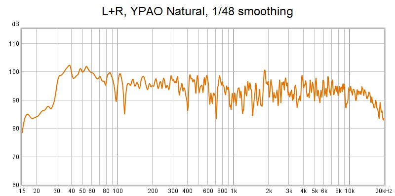

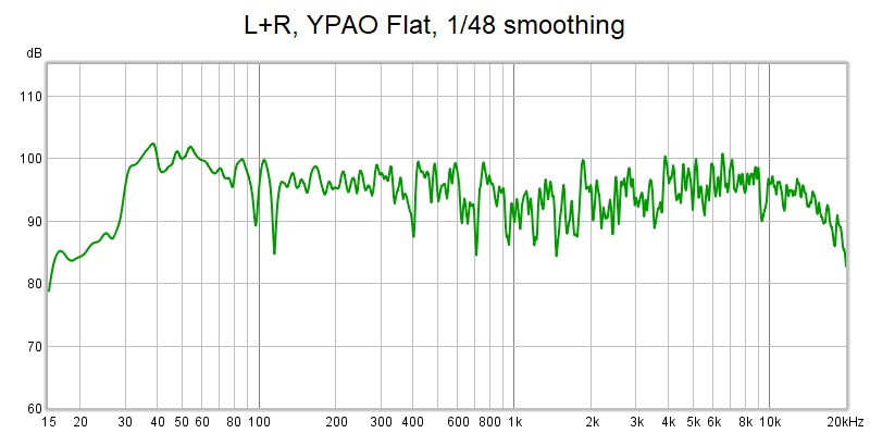

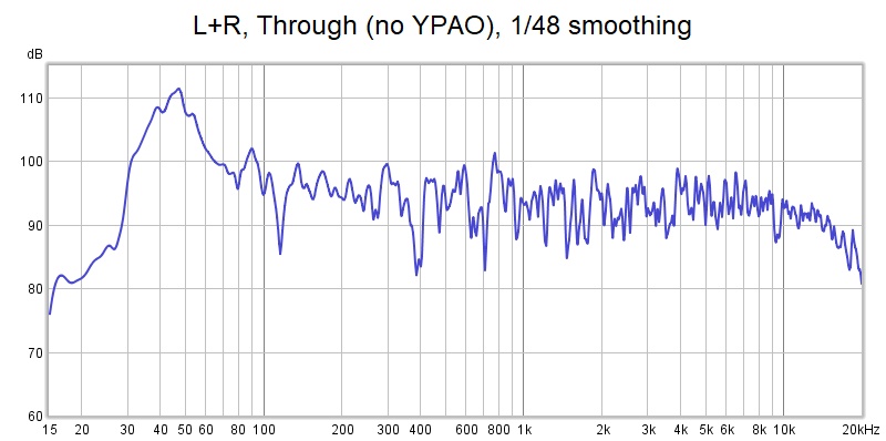

Looks quite good actually, I don't know about Dirac Live but I would think that Audyssey XT32 can do a little better in terms of flatter response. That's just a guess based on what it did for me. You should do a sweep with both channel on at the same time, i.e. stereo mode.
Yeah, maybe Audyssey or Dirac could fix those 2 dips around 100hz, and then my bass would be nicely linear. With manual PEQ I can't really fix it as the freqs are locked to 78hz, 99hz, 115hz. I tried tweaking it a lot already through the values REW generated (you can lock the frequency and just have it adjust gain and Q) but I just couldn't get it close enough to even out that dip (particularly on the right speaker it's huge).
I doubt that, XT32 could probably reduce those dips by a couple dB more at best. As you know, dips are tough to deal with. It does look like YPAO did a great job for you, you may be able to improve it further with some manual tweaking, but I really doubt you can do much better. Between 30 and 200 Hz, if you ignore the huge dips, you are within +/- 3.5 to 4 dB, that is really respectable for 1/48 smoothing.
