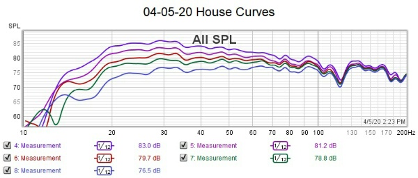

Yes, running Audyssey EQ, Reference, no custom curve. I dial it in flat and use DEQ as my curve, RLO -10 and it works really well. I haven't been brave enough to to much with the app yet.
Here's an example of the effects from a previous calibration of the different RLO settings in DEQ
How can I tell which line is which RL setting?

DEQ off is a flat response. RLO -15 will have the least effect (bumping bass frequencies from ~100 hz and down by approx + 3-ish dB) and RLO 0 will have the strongest effect (approx +10 dB). The higher you have the volume the less effect the offsets have. Blues Traveler, TOOL, STAIN'D, Chevelle... all pretty decent bass and you should be able to hear the differences. If not, you might be a candidate for REW and a mic!
