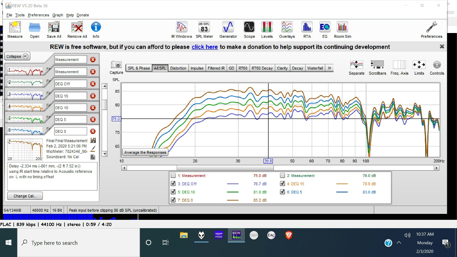

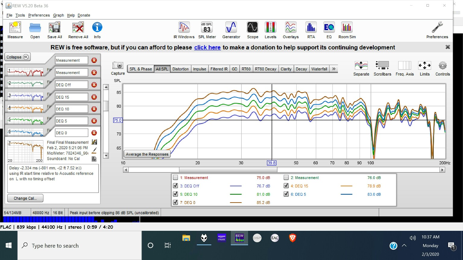

FOUND IT!
I knew I had one labeled somewhere!
For the record that's an older set of sweeps. What I have now is significantly better. When I generated some filters for that one I had forgotten to check the box for "MINIDSP 2x4 HD" so what I got was a generic weaksauce file. One of those easy things to overlook when playing with this stuff.
panteragstk
panteragstk
FOUND IT!
Damn weaksauce messes things up every time.
I'm guessing all of those were at the same volume level?
