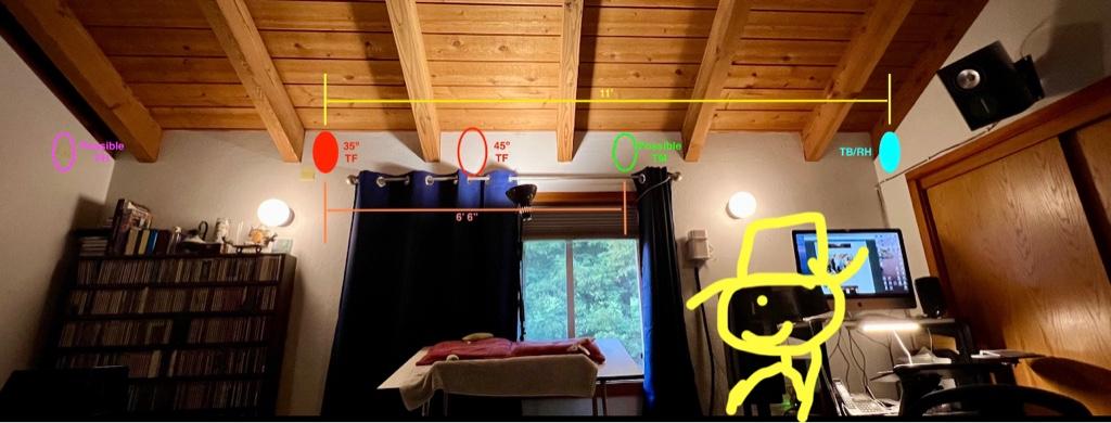

Well I have been agonizing over this. It’s definitely easier to make decisions about your own room vs recommending what your friends do.
So basically I am thinking about it like it’s my room. At the end of the day, I am still going to vote for .4 at 45°. Part of the reason for that is imo, 7.5’ to the center of the speakers is pretty low. I know 35° is inside of Dolby’s recommendation, but I’m afraid that it’s just too low. You may get 35° above the ear, but I just think the separation between the bed and height layer isn’t enough. 9 or 10’ ceilings would make me look at it differently. From what I recall, the guys that have had the most benefit from .6 have multiple rows, and/or very long rooms. Again, with a single LP I don’t think that matters as much. If you look at the pic I posted earlier it shows an “X” over the listener. Imo that gives the best left to right and front to back overhead imaging for the listener as well as maintaining good object placement. If you could get them higher, I would weigh things differently but I will stick to my recommendation.
Keep in mind I am basing this mostly on my own 7.x.4 with TF and TR. I have experience with other systems, but obviously I’ve spent the most time here. I can tell you I have no internet in .6 in this room. Now, if I was starting from scratch with a brand new room I would strongly consider.6, but would depend on how the content is handled. I’ve seen a lot of complaints about TM not being used, or conversely TM only being used on some tracks. Too much Fukkin around lol.

Front height would go up front, and makes more sense if I bring the TF back to 45° from 35°.
but that’s the trap question. For me, I don’t wanna shoehornna speaker, but I do wanna possibly maximize what’s available.;)

Well it’s definitely a fair question. I also hate leaving stuff on table. I’m just not sure you’d be clearing the table as much as just making it larger.
I guess if you really won’t sleep at night, I’d do this…
Install and wire all .6 speakers. Set the 6012 to run them as FH and RH. THEN when you buy a new processor it will all be ready.
If you think you’ll be satisfied with.4, then mount em up and FTW. If my math is right. That would be 3.7’ fore and aft, with about 7.5’ between them. That is indeed pretty close together, but considering the low height it makes sense to me. Too far apart and phantom imaging will suffer.
Another thing though is the room width. At 11’6”, you might lose a foot on each side. That leaves about 9.5’ apart between the tops. Imo that’s close enough to the 7.5’ distance front to back to form a square overhead. Idk! Maybe I’m starting to split hairs that aren’t there!

I think I will look to bring the TF in more, and then decide when I upgrade the AVR what to do.
It honestly doesn't seem like pushing the TF out to 35º is gonna make a difference. If I were to try and add TM, certainly, but it really sounds (from you a @Danzilla31 both) that the key thing is separation.
As it stands, TF and Mains are almost the same distance... yes there is separation, but I'm feeling like that may not be enough, whereas if I bring TF back a little, I get more distinct separation.
That leaves room for making FH an installation later, as there will be more separation between those and TF... I can actually try that out easier, too without a proper installation and using some different Speakers.
SO...
It's going to be the Open Red and Light Blue Ovals:
