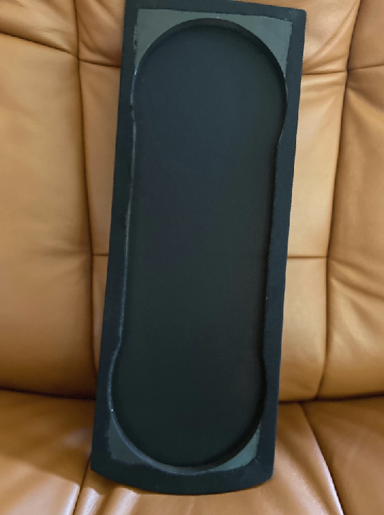

Here is the back of one of the grill covers for my Veracity ST speakers. The speaker cabinets are the same 8" width as SongTowers. The magnets are not at all visible. They're buried in the grill frames and in the speaker baffles.
The frames overall are 6¾" wide × 18½" high × ½" thick. It appears to be MDF painted black.
Notice that the top is flat, and the bottom is slightly rounded.
Let me know if you want other photo views or details.
That gives me a good idea. Thanks.
The key thing is to locate exactly where those buried magnets are on the front of your SongTowers. On the grills, drill holes for the magnets so they line up with those on the speakers.

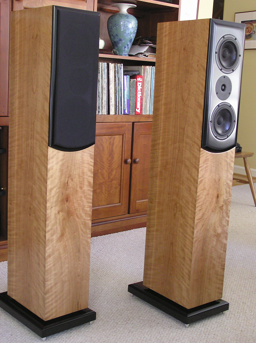

See the fronts of my speakers, without grilles, on post #30 in this thread. There is no visible sign of any of the four magnets.

There are magnets in the 4 corners on the Song Towers. I tested them.
Whew, I for one feel much better that you don't have to actually drill into the speakers to insert magnets there.
Should be pretty easy to make a grill then. Make sure you use neodymium magnets for attaching it to the speaker.
Thanks for all your help. I can use what you showed me and look at my son's covers to get a really good idea even if they are a different size. Should not be too hard. Now, I just need time since I still work full time.
