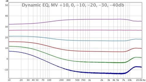

Hey @Pogre. Can you try and explain RLO offset if you don’t mind? I have mine set to 0 . What would changing it to -10 do?
It changes the point at which DEQ is engaged.
So at rlo at zero, when the MV gets to zero, Deq will being doing nothing. At -10 it will have applied some boost, at -20 or -30 much more boost.
RLO changes the amount of boost applied for a given MV level.
Here’s what DEQ looks like on paper.
As you can see once you get above MV-0 it starts to reduce boost.
I can’t remember the algorithm, but it’s something to the effect of, for every 6db MV setting below zero, Deq applies 3db of boost(bass range). Once you get to MV zero, no boost.

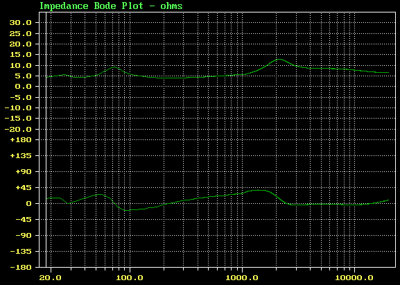

Here is the impedance magnitude and phase plots. I don't recall what the crossover frequencies are for this 3-way speaker.

IMO, both the impedance and the phase angle curves are good. That is a 4 ohm system and there are no serious dips in the impedance.

That is very interesting. It is described as a ported reflex enclosure, but it is not.
Lets add the FR
Notice there is only one peak of impedance and a very small one at that, and not two as there would be with reflex tuning. The nadir between the twin peaks would tell you Fb. So there is no Fb.
If you look there is a slight rise in output centered on 80 Hz, and then the roll off below that is 12 db per octave, not 24 until 30 Hz and then it rolls off 24 db per octave.
So this is not any of the reflex alignments. So that port has an unusual function, and seems to be behaving much more like the old Variovents on some Dynaudio designs from years ago.

I noticed that but my first impression was that it was a sealed design. Over the years, I have seen a lot of bass reflex impedance curves and the port would have to be really small to show a rather low bump in one of the tuning impedance peaks, and I've never read or heard of that phenomenon.
To tell you frankly, I have trouble agreeing with you on this. Show us an actual impedance curve of an enclosure from another manufacturer than Ascend or Axiom where one of the impedance peaks is that minimal.

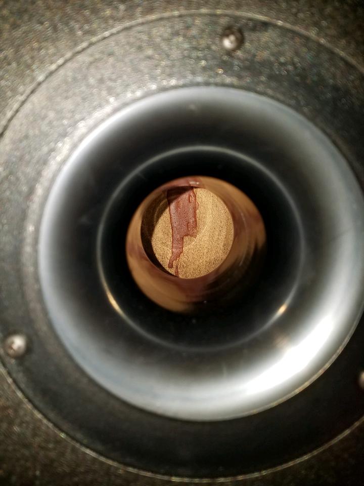

To whet the appetite... :p
The bass drivers are definitely ported. The mid is in a sealed enclosure.

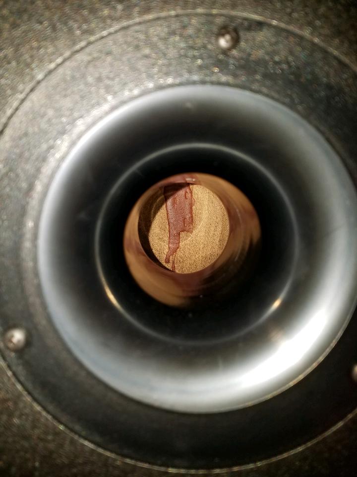

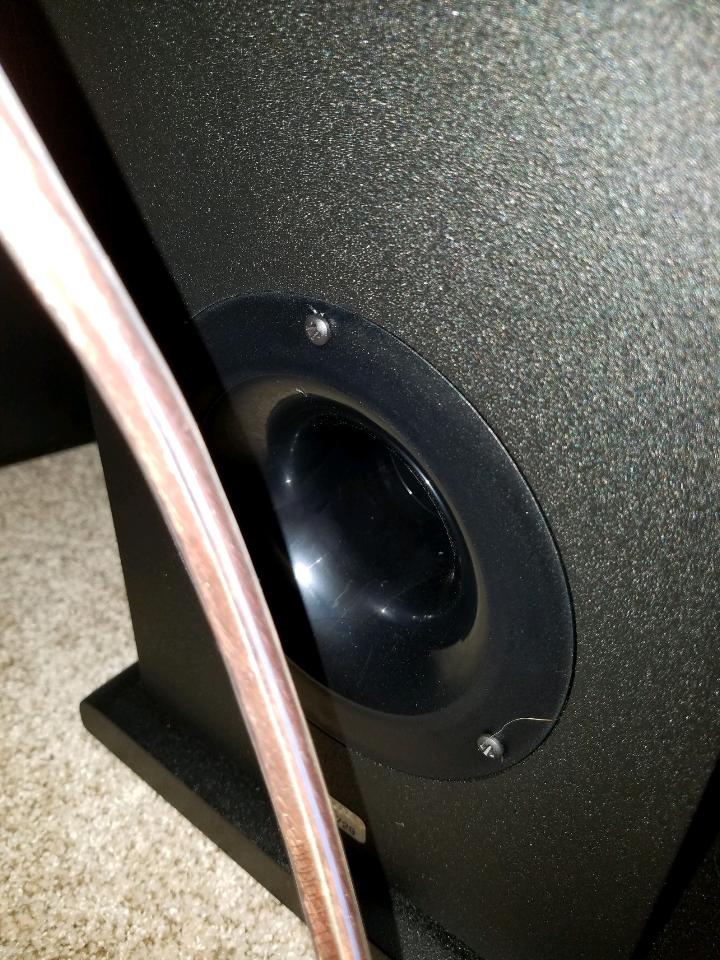

View attachment 36975View attachment 36976
The speaker does not have the characteristics of a typical ported enclosure though and it looks to me as if there is something at the origin of that port giving resistance.
I think their has to be some resistance to airflow, or deliberate miss tuning to give those results. That is not a typical tuned Qb4 box by a long shot.

There is nothing at the port origin to block airflow. The cabinet is wide open where the port is. The port does seem unusually short to me, however. At about 5" in total length, it's shorter than the ports on any of the other speakers I own. It appears to be flared on both ends.
