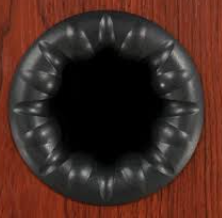

Ascend Acoustics standard issue port. One reviewer referred to them as looking like a "gorilla's anus". :oops:
Sooooooo I'm not sure what that says about me I like gorillas anus's? :oops:
I think I just hit rock bottom guys I'm going to have to get some help :eek:
Trebdp83
I've seen a port like that before... Oh yes, it was after the great chili cook off of 19... That was the last time I used a hand held mirror.:eek:
