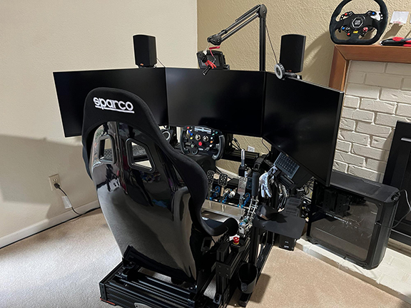

Don't just think gaming is for younger people. I am a 58 year old gamer with a PS5 and an Xbox X. Here is also my racing setup...
Woooow! Awesome!!! With such a setup you actually don't even care about the 2.1 issue with the AV receivers :D
