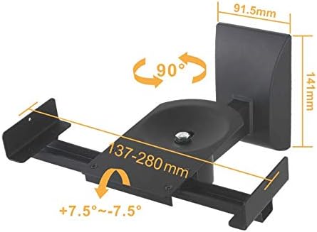

I bought another pair of side clamping wall mounting brackets for my surround speakers for the bedroom. I really like the B-Tech77 but I tried these for a change as they seem to have a lower profile...

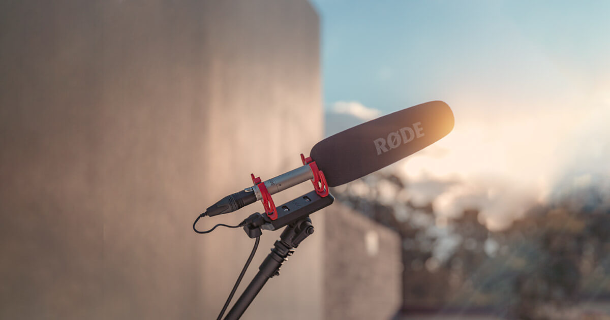

Because I'm getting some insurance money coming in, I've ordered and received this.
For my UMIK I bought a shockmount from Rode that works excellently, but when I recently bought the Rode Videomic NTG I got a shock mount (sm3-r) that can fit on a camera, is adjustable horizontally by a slider and can be mounted on a mike stand. Fits the UMIK just fine, and the slider will work fine for fine tuning next time I do measurements.
I bought this one, thinking I could not put the sm3-r on a mike stand at all:
PrimeCables Universal Sound Bar Speaker Bracket for Wall Mount
Dipole heaven! That reminds me I gotta put up my heights speakers.

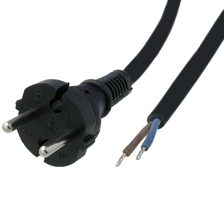

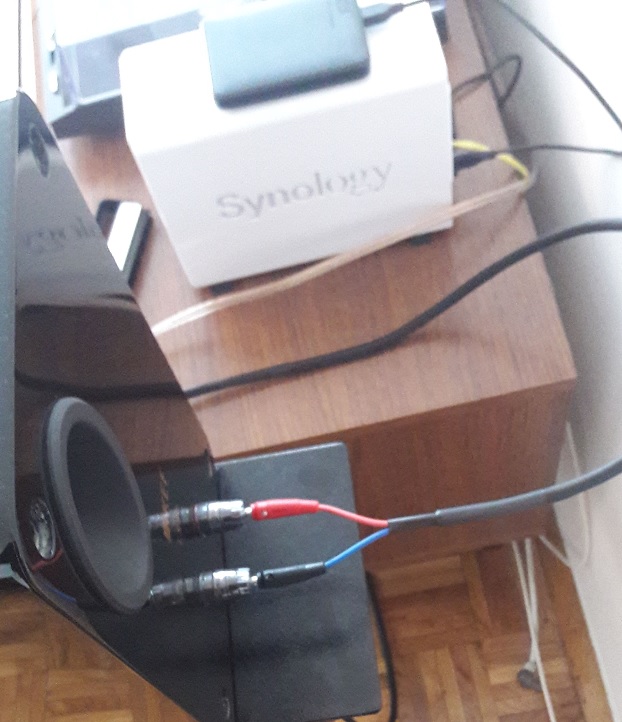

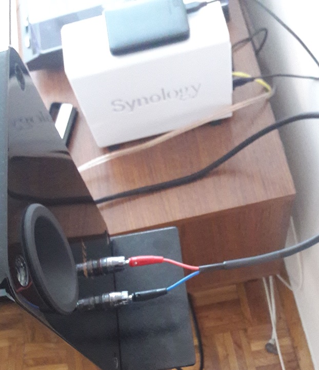

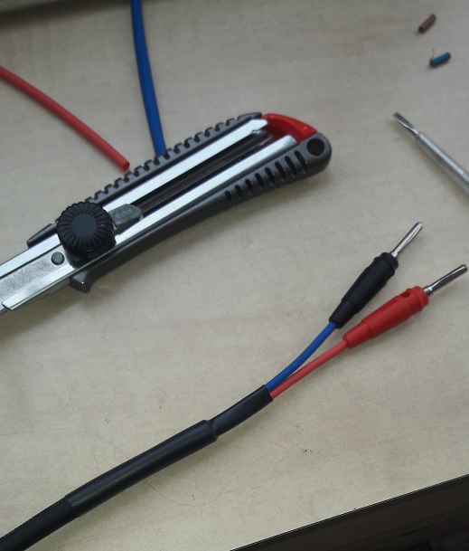

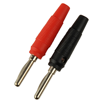

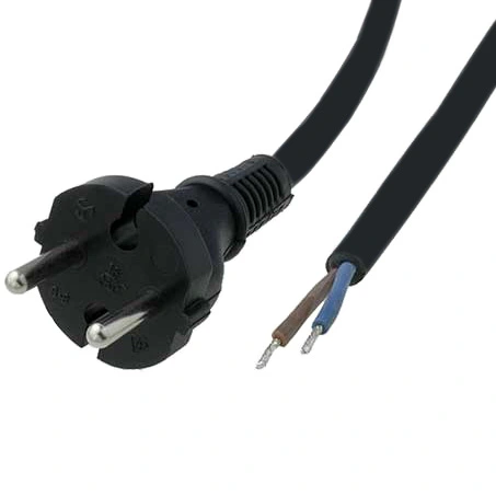

I bought a plain two wires power cord with 15 gauge multiple strand copper. It is rubber insulated so it's very flexible. Much like this one but mine wasn't tinned:
I got some heat shrink and simple banana plugs:
And I made these:
I must say I'm very happy!
Total cost (and I mean total) 15$ for both speakers.
And I made these:
Great job!

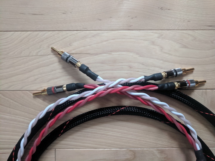

I spent almost 4x that to make my own, but I like them and they're secure. I used Canare 4S11 cable, which works out to about 11 gauge with two of the 4 leads twisted together. Some shrink tubing, locking banana plugs from Blue Jeans Cable, and done. I've made 10 foot (4.7m) and now 14 foot (6.6m) now, and while I can't detect a quantum leap in sound quality, my LS50's are far enough from the wall that they're visible and look good. :D

I spent almost 4x that to make my own, but I like them and they're secure. I used Canare 4S11 cable, which works out to about 11 gauge with two of the 4 leads twisted together. Some shrink tubing, locking banana plugs from Blue Jeans Cable, and done. I've made 10 foot (4.7m) and now 14 foot (6.6m) now, and while I can't detect a quantum leap in sound quality, my LS50's are far enough from the wall that they're visible and look good. :DView attachment 41095

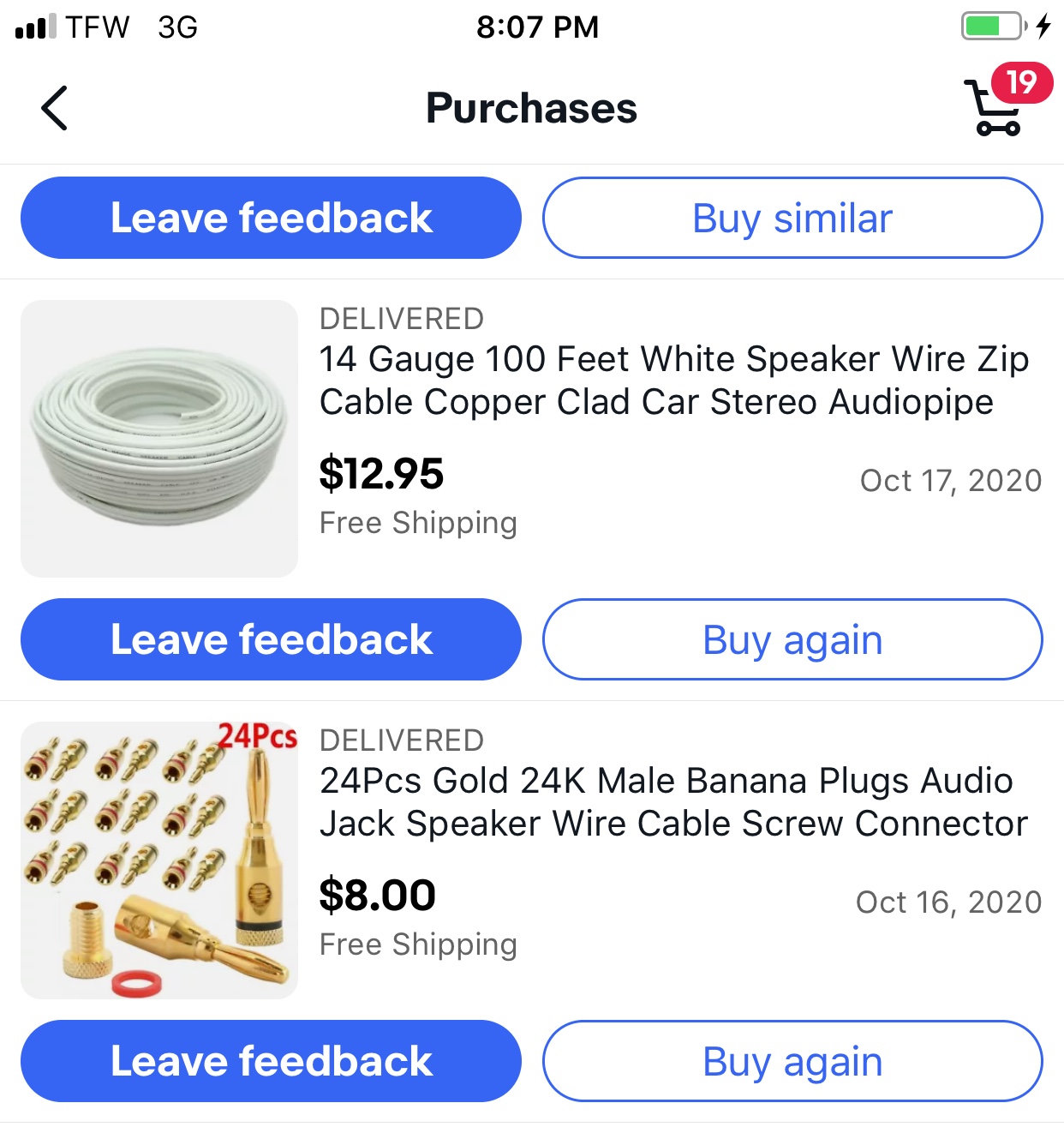

I did exactly the same only I used mono price banana plugs and covered the whole twist area with shrink wrap Iam happy with them . I did notice my outboard amps run a little cooler with these .

@KenM10759 Man, those are really nice looking cables. My lady said she prefers matte black and simple, neat, thus the choice. What I enjoy the most is the fact that they are made from plain power cord. I got exactly the results I was going for and very, very cheap.
The way I'm organizing my system a lot of my cables are visible, so I'm trying to hide some of them, reduce some of them and make pretty the rest. Couple of my friends and my brother also need some, maybe I'll make some for them. It amuzes me to make them. Though I have to find heat-shrink tubing as meter-ware. I think they are overcharging when you buy asorted.
There's a "pic or it didn't happen" rule... ;);)
I like cable pants on the ends of the wiring.
Lol well I can’t get the pic to upload on here for some reason . But the only expense I had in the was for shrink wrap and the banana plugs from monoprice and the cable was free to me from a friend I did my front mains and my center channel I didn’t use the pretty jacket on them as once installed they are barely seen but I do like the looks of that stuff I’ll try to make the file smaller to post .

I know about pants, but none are available near me and I wanted to start making them and not wait for some shipping. Although, before I placed the last piece of heat shrink, I first applied some shrink to + and - to make it neat (the cable came with some ugly pale brown and something).
