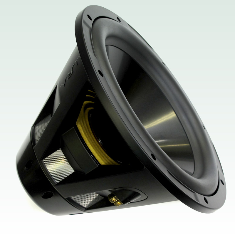

1) I just placed my 201/2 on 12" black wood stands atop my black RBH Signature SX-1010 subs because I saw AJ do that with his Overture 1212 speaker system. :D :D
2) And although my RBH & Funk subs are clean & flat up to 180Hz & 250Hz respectively, I have changed my XO to 100Hz. :)
3) And I have a total of seven subs spread around my room. :)

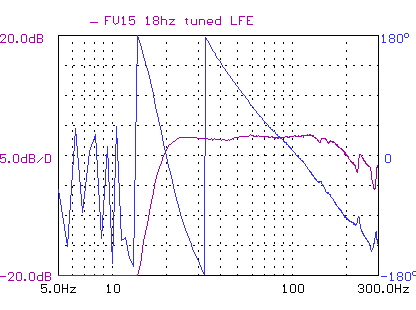

And I don't own Rythmik anymore, but I recall they can go flat up to 150Hz if you set the XO to the sub, instead of the AVR.
Also as stated on their site, their new H600PEQ2 also provides an LFE mode that extends the upper end to 200hz.
Their $598 shipped LV12R is flat up to 300Hz.

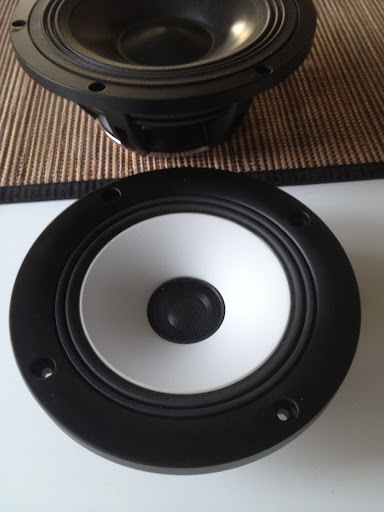

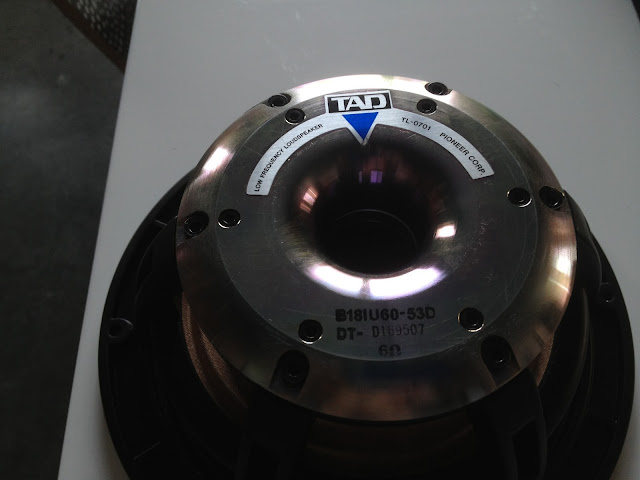

The cabinets are an aesthetic compromise with my wife. I wanted them to look more like the Grimm LS1's (Another riff on the standmount + flanking sub concept) but with the bass drivers vertical and facing the wall behind them rather than horizontal and upfiring:
Except obviously with better parts than the Seas Excel woofer and diffraction-guide dome tweeter on top, and Peerless XXLS down low. (Though the XXLS is a very good woofer.) Parts more like this:
(5" Pioneer EX "coherent source transducer" concentric driver, with TAD/Pioneer 7" midbass in background.)
(7" TAD/Pioneer midbass)
(Aurasound NS12-794-4A)
But she wanted them to match the TV cabinet. So I compromised a bit on performance (squared off edges rather than nice big diffraction-mitigating curves) and she compromised a bit on size (they're taller and about as wide as Salon2s or 207/2s, but less deep).
Side and rear surrounds are commercial speakers. KEF R800ds and Q100, respectively.
