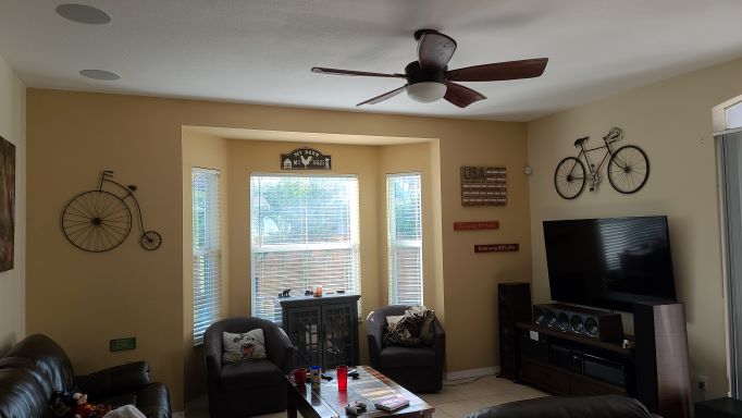

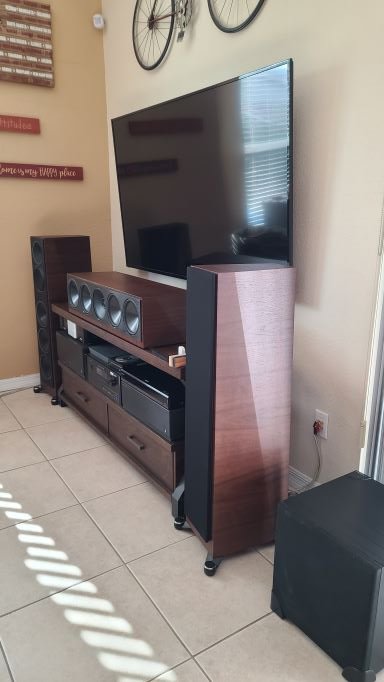

Over the last few years I have been upgrading my home theatre as budget has allowed. My current setup ( and how long I've had it) is as follows:
Anthem AVM60 - 2 years
Anthem MCA 50 - 8 years
Founder 100F - 2 months
Founder 90C - 2 months
Klipsch CDT-3800 C-II - 2 years
Velodyne SPL-12BV - 17 YEARS!!!
Guess who is on the chopping block!! There is actually nothing wrong with my Velodyne, it still works very well and despite a very large room (26'x18'x10' tall ceilings) and having to be placed in the middle of a wall instead of a corner, it manages. The addition of the Founder speakers has been a revelation compared to the Klipsch setup I had before, so overall, I am very happy. But couldn't it be better?? YES!
The last time i ran ARC, i noticed that the sub roll off is STEEP on the bottom end, which got me thinking its time to replace it with something that can dig deeper, although listening to the 100F's without the sub sounds at time like the sub is ON...they truly are amazing. After some research about room sizes (mine is VERY large and untreated) I've realized that I likely need either 2 subs with approximately the same specs as the Velodyne, or 1 much more capable sub to make a worthwhile difference. Alas, with the pandemic, and the fact that subs sound different depending on which room you place them, it seems like auditioning them is not happening...so I am here for advice. Below you get a taste of the room which is the Family room and kitchen in one open area.
As you can see, I'm limited on space on my display wall and as much as I'd love to move the sub into the corner, it'd move my TV up against the door and the center stage would move as well as the sweet spot which is currently my recliner! It seem like I'm on the fence and the 2 main manufacturers on my list are SVS and Paradigm...although I'm all ears to other suggestions. The Paradigm 1000SW or 2000SW would come in the same walnut finish as my Founder's which would be VERY pleasing to me, but I'm not going to choose looks over function at this point. In the current sub location i do have room for a large sub like a 2000SW or SB16-Ultra, but would that be enough "more" than what I have now? For the price of entry of a 2000SW, I could have 2 SB-4000 subs and place 1 where the Velodyne sits and then try and shoehorn the other one to the listener's right (there is a bar where I can stuff it in the corner). I'd love the low end extension of a ported sub, but the PB-4000 is 30" deep which wouldn't work in the subs current location unless if I went with something like a PC-4000 which has a smaller footprint.
Any thoughts/advice would be great...looking at SVS's site, it seems like all of their subs are going up in price soon.
Thanks!!

2 SB-4000s would be a really good option, better than a single SB-16 Ultra easily. That is probably how I would swing in your situation.
By the way, the left speaker is placed so close to the wall that you might consider putting some acoustic absorbers on that wall. That has to be creating a significant acoustic reflection since the other speaker has no lateral reflective surface. It's probably tilting the soundstage to the left a bit.

I definitely agree that an sb16 wouldn’t be the best choice. But IMO, a pair of PC4k’s would be pretty awesome. I MIGHT consider sealed if that was a suspended floor, which it looks like but I’m just not a fan of sealed subs… Plus the PC’s smaller footprint should prove helpful in placement, compared the the PB anyway.
Just about anything would be an upgrade thought imo. Also, I would consider rotating the layout if the room could possibly accommodate it. Even possibly putting the TV and stand etc in the bay window.
Edit: it does look like a concrete floor. So again, I’d vote against sealed. I have a similar sized listening space on concrete, and I think ported subs would really be better.

Yeah, I can see putting TV in Bay Window. Would be able to open up his front mains better sound stage to start for sure. I saw that but didn't want to throw any shade on his setup cuz it is nice. Very clean look but he does have options for sure with implementing some changes to get a better sound stage.
William Lemmerhirt
William Lemmerhirt
Indeed. I was thinking about how to present that. it is a nice room indeed. I love the bicycles, and it looks inviting to me.
BUT!!! I can’t walk into a room and not try to figure out how I’d layout a system in it lol. I totally agree about opening up that stage. I think it would be transformative.
I wonder what the right wall looks like…..

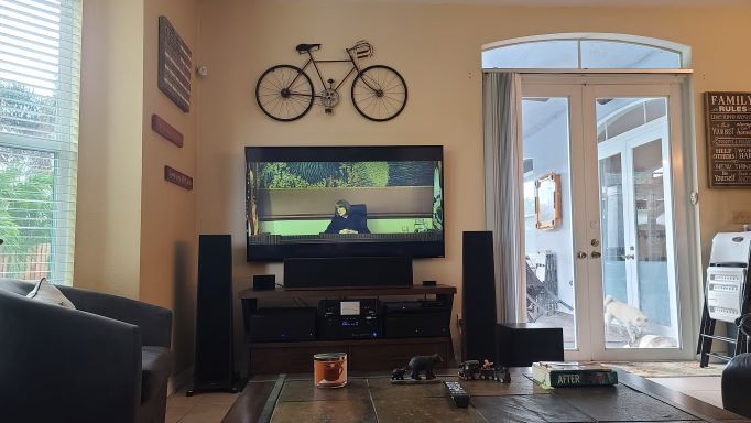

I finally got brave and enlisted the kids to help me unbox the PB-4000. It honestly was not as bad as I thought it'd be even though i got repeated "should you be doing that so soon after surgery" looks from the Mrs. I placed the PB-4000 where my existing sub was and backed it up to an inch from the door/wall. Without the grill on, it is pretty much flush with the front of the 100Fs. I really can't complain...it is a behemoth. At this time, I have not run any REW to adjust output from the PB-4000 and have not run ARC. I literally plugged it in and have been listening...it has been a revelation! Edge of Tomorrow pretty much brings the house down now. Everyone in the family has commented that they can feel the explosions, etc. We were watching "Taken" last night and some of the gun fights felt like I was at the range...you could feel each gun shot. I now need to make some time to work with REW and make adjustments as needed to the PB4K and then run ARC for the whole system as I've been running uncorrected for some time now...I wasn't happy with the previous corrections made and turned off the ARC corrections. It seemed like it dulled the sound down too much.
Once I upgrade the TV (it has a dark spot forming on the left side) the new TV will be larger and I'll either have to open the space between mains or raise the TV significantly...or a combination of both.
Also, someone had asked to see what the other side of the room looks like...its the kitchen.
