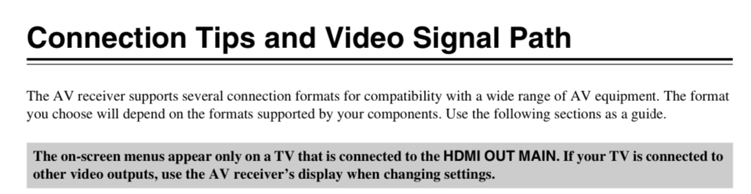

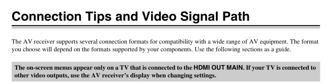

In other news, while analog devices using a composite, S-Video or component video cable connection can have their video signal output from the component monitor output, the onscreen menus are available only when connected to a TV using HDMI. This is an unfortunate limitation for use with an older TV or monitor lacking an HDMI or at least a DVI input port. You will currently have to navigate the menus using just the front panel display.

That's ok since the same would still apply to the DB15 connector as it is analogue. Cheapest option mentioned is the DB15 to component cable (red/green/blue) and use the component monitor out connection on the receiver. The one unknown is whether the receiver displays the setup menu on the component monitor out or just on the HDMI out.
Trebdp83
Unfortunately, we now know.

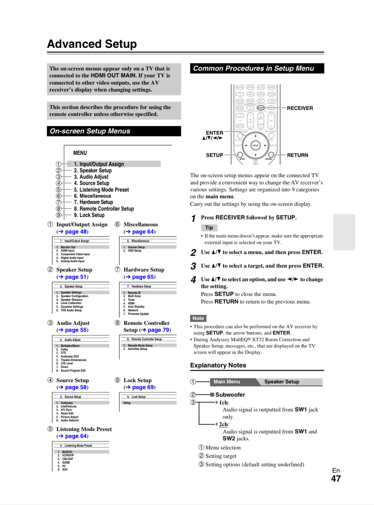

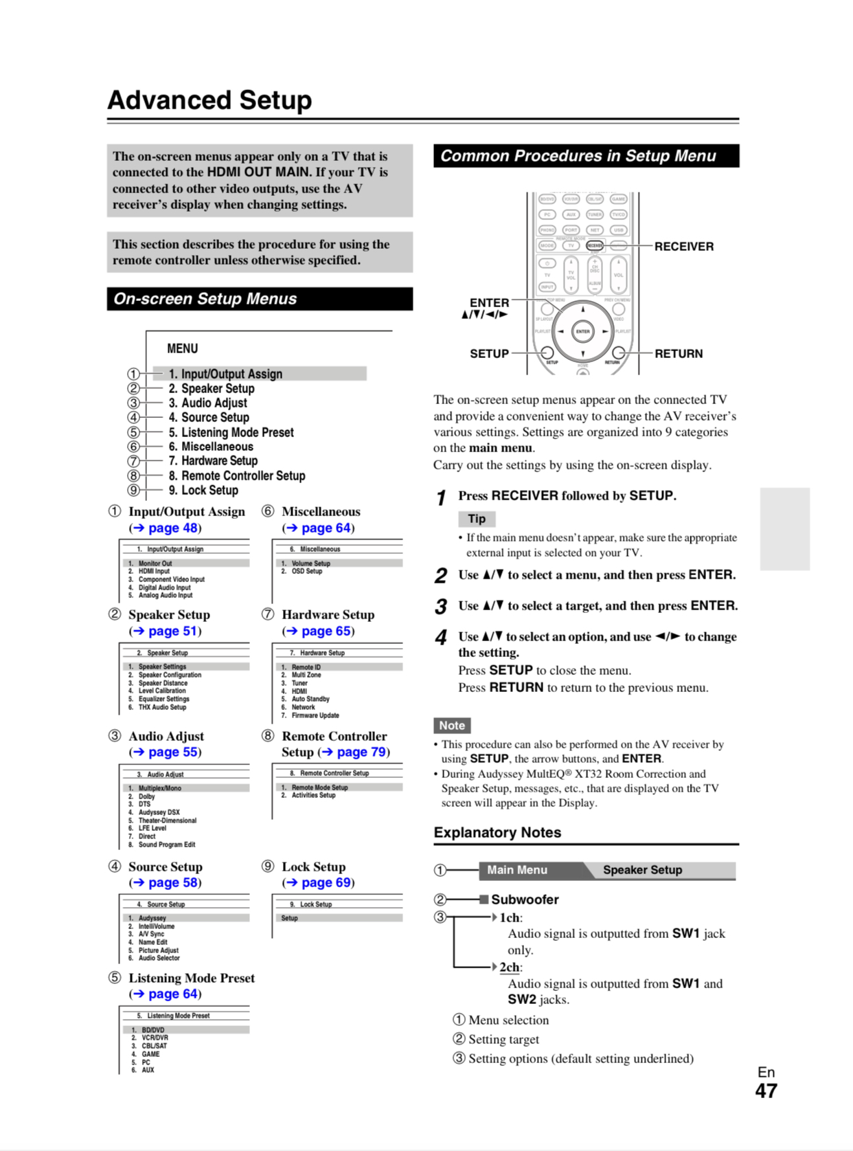

Yikes, ok. First, before ever trying to change any settings, always press the RECEIVER button in the REMOTE MODE section of the remote controller. This way other button presses will be for receiver settings rather than input device settings. After pressing the RECEIVER button, press the Setup button. You should see "1.Input/Output" on the display. press the down arrow to move to "2.Speaker Setup" and press ENTER. "Speaker Settings" should be displayed. Arrow down to "Speaker Configuration" and press ENTER. Then, use the down arrow to see the settings for the different speakers. Audyssey will have already made settings for them that you can adjust yourself.

That's probably too much to ask. I'm slowly learning how to navigate, so I will only ask when I don't understand something.
I should not be configuring video until I have a HDMI TV. Section 1 seems to be controlling my friend Monitor Out and I would like a little understanding here.
satwar
Audioholic Intern
It's all good. Onkyo hasn’t changed the on screen menu procedures too much so I’m familiar. Download that manual to a computer or Smart device and start studying. It will take you to the desired section when tapping hi-lighted pages throughout.

That's what I need, is a map. Thank you.
