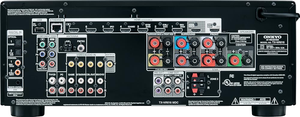

On the Onkyo TX-NR616, the Zone 2 and Zone 3 "Line Out" jacks are fixed volume and are not controlled by the master volume control. So, they should do what you want for the headphones, and I think even the VCR.
One note - only analog input sources are output through the Zone 2 and Zone 3 outputs. What sources are you wanting to use?

I want to use all sources. As my TV is connected via HDMI, I was told by the Onkyo rep to also use analog Left and Right connections as well in order to use my headphones for the TV, as like you said, Zone 2 only outputs analog. The rep did also tell me that I would not be able to control my headphone volume at the headphones...just at the receiver. I sure hope you're right! As this would actually solve my problem!

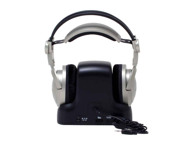

Information on those hadphones is faurly sparse. Is ther any way they could be connected via the headphone jack or speaker connectors?
As for the headphone jack, I'm ptetty sure they are controlled by the unit's voume control but you could always set it at a high level and use the volume control on the 'phones to adjust it to your preferred level.

Regarding the VCR, the 616 has audio and video inputs for one, and you might be able to use the Zone 3 fixed outputs to connect audio to it. Because the 616 will convert video from composite video inputs to the HDMI output, you might also be able to connect the composite video "Monitor Out" to the video input on the VCR if you use other composite video input sources that you'd like to record.

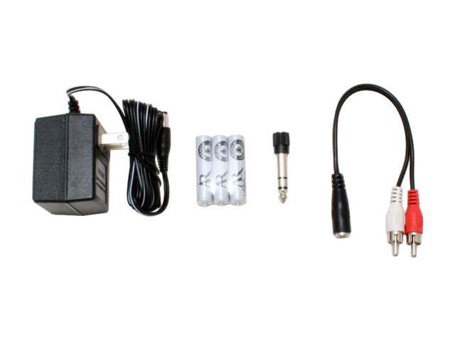

Hi, Mark. Those headphones have a 3.5mm headphone connector, but they come with an adapter to connect them to left/right RCA audio jacks.
Yes, I could connect using the headphone jack, but as you said, that would make it necessary to have the receiver's volume turned up and that would not be good as I live in a small apartment and I rely on being able to blast my headphones w/o having to have any external volume to disturb neighbors or my daughter while shes sleeping. I do not believe you can connect these using speaker connections.

Also there are no left/right audio out jacks on this receiver!
Where do you see a/v inputs for a VCR on the 616?! Please, do tell! I did not see any and tried to use other inputs but did not work.
OK. I pretty much get the "Zone 2" connections I'l need to make....but "Zone 3" I have no clue.
I'll admit, I haven't used a VCR in a while, but my recollection is that you'll need a set of left/right audio inputs and a composite video input (unless you have a fancy VCR with component video outputs :)).
You should be able to use either the "GAME," "STB/DBR," "CBL/SAT," or "BD/DVD" connections in the "VIDEO/AUDIO IN" section shown below that have left/right audio and composite video inputs. Because each of those sources has an HDMI input assigned to them by default, you might (but I'm not sure) need to go into the set up menu to make sure that the analog inputs get used for whichever source you want to use for your VCR.
