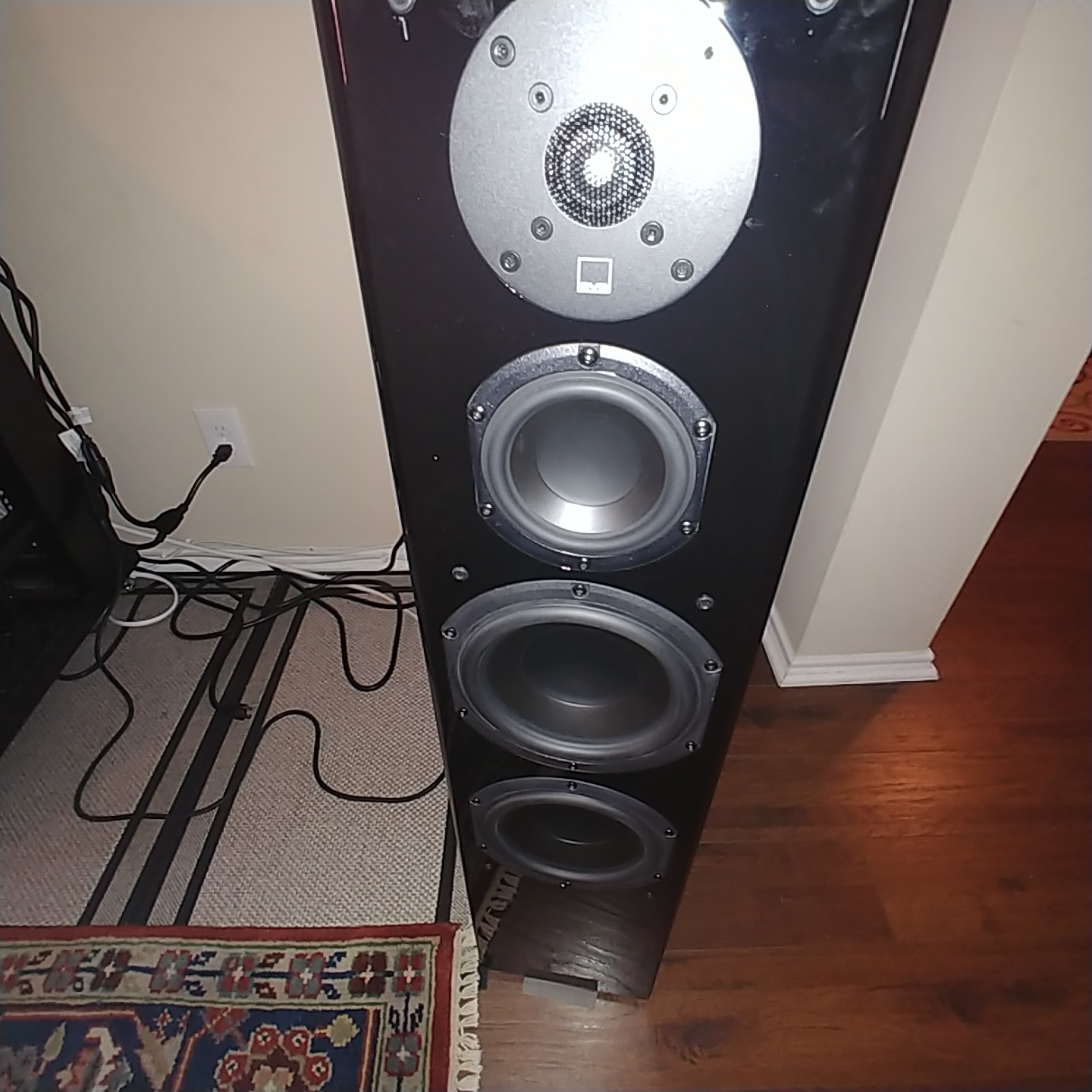

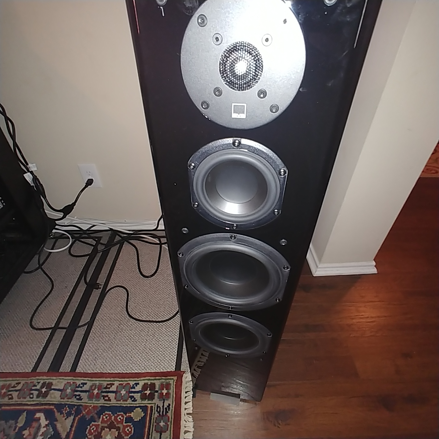

Okay fellas got some news
Thanks to your advice I unplugged the Emotiva and put the Crowns directly into the wall.
Still got the hum
But when I listened to the speaker more closely I realized it's not coming from the tweeter. There's no noise from the tweeter at all.
But a lot of noise is coming from the midrange driver below the tweeter which is why I mistook it for the tweeter lack of knowledge and too much bias from info I'd read I failed to investigate more closely
A lot of the hum is coming from the speakers underneath the tweeter.

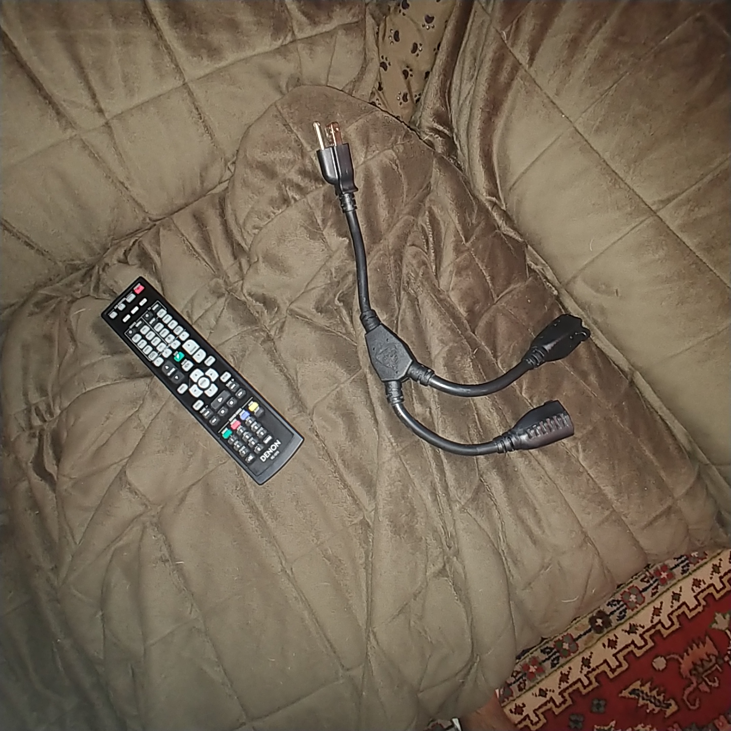

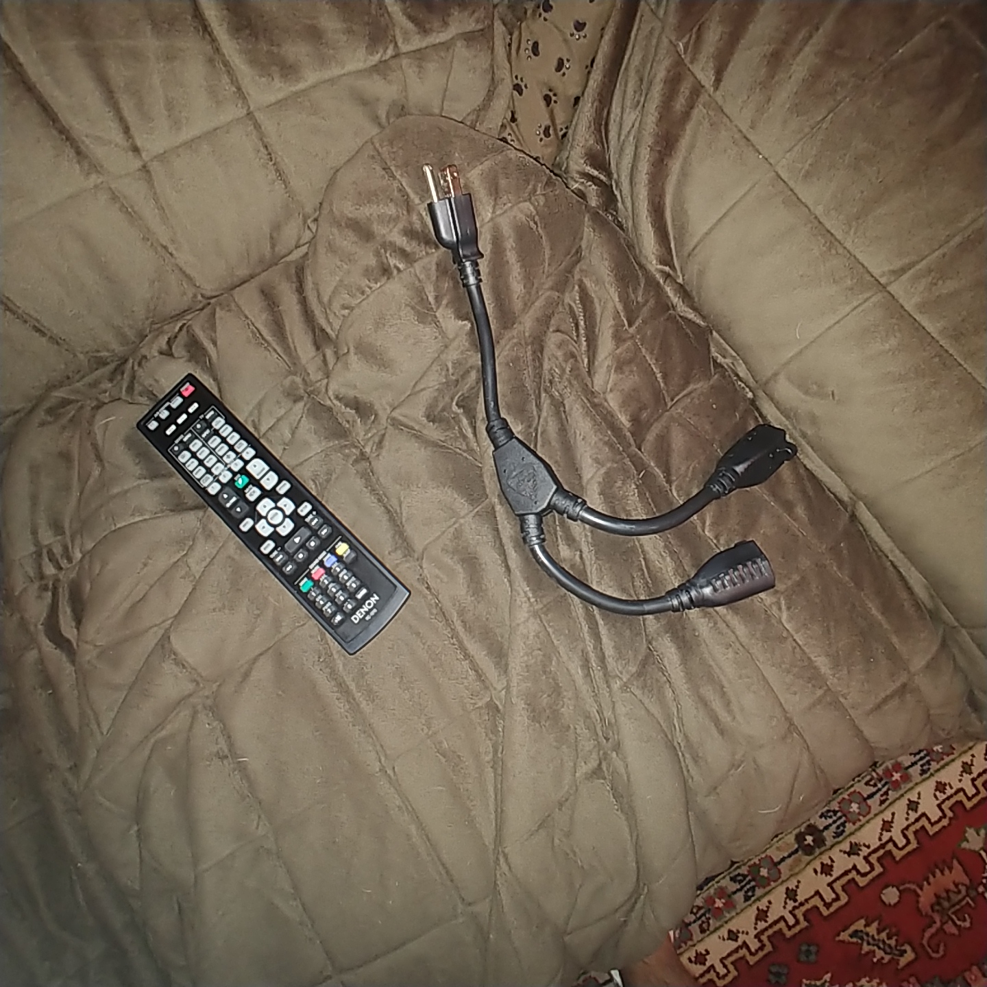

That midrange driver is where I'm hearing it I thought since I was using this to plug them both into the wall20190318_142112.jpg
It might be the problem but when I plug them both directly into the wall same hum
When I remove the Rica's from the crowns no hum plug them back in there is a hum
Still got the hum

So I'm not sure what this means this must be the dreaded ground loop I'm thinking now I guess I just have to isolate it right?

It's coming from all 3 towers and it seems loudest from all 3 midrange speakers
That midrange driver is where I'm hearing it I thought since I was using this to plug them both into the wallView attachment 28734

It's not a high pitch whine more like a lower just hum that is constantly there like the hum of a computer running in the background you know that humming sound electronics used to make?
