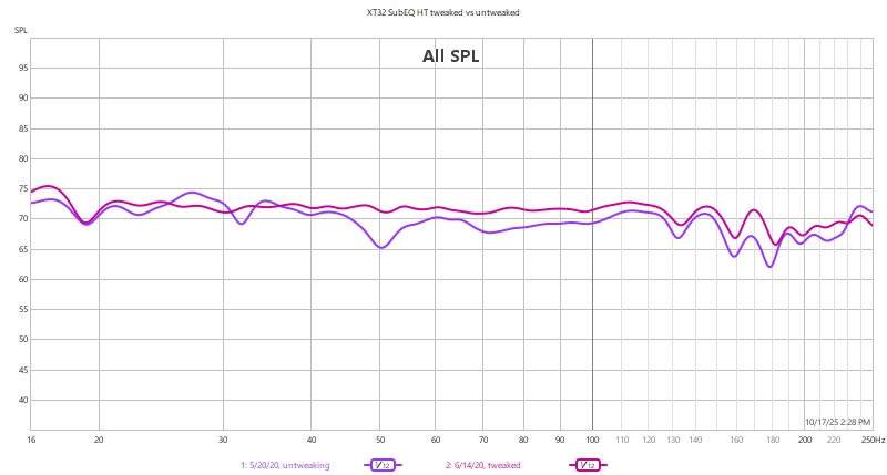

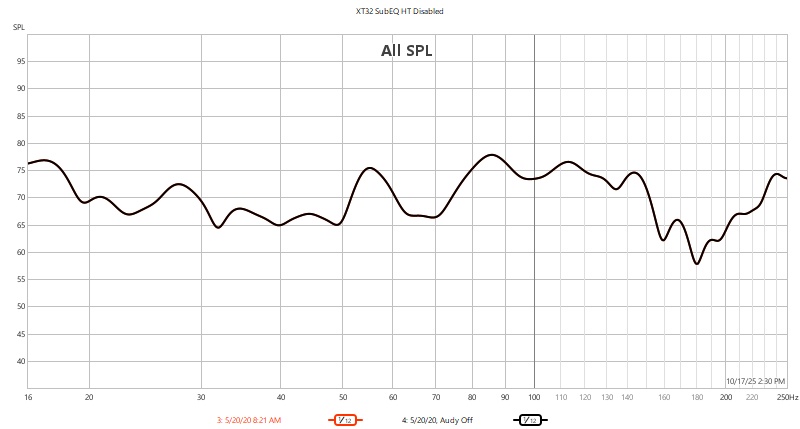

I would like to share my experience with the perceivable effects of Audyssey untweaked, tweaked, and disabled:
Here are the measurements, front left, right, subwoofer left and subwoofer right:
Audyssey tweaked with the Editor app, vs untweaked:
My old ears in my room, and setup could not tell a difference let alone which one sounded better to me.

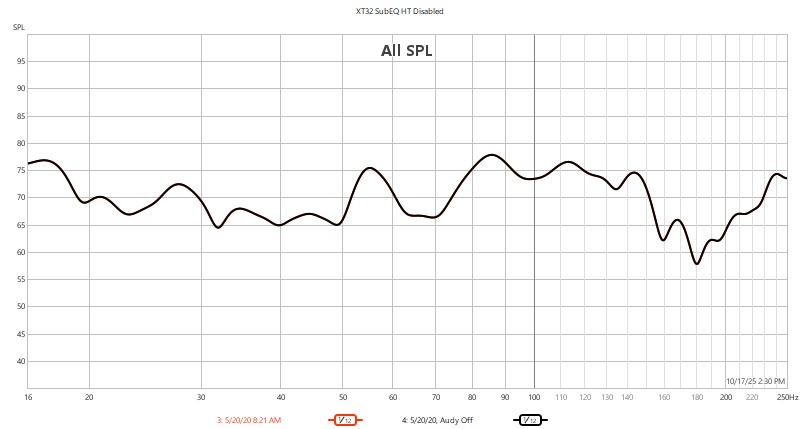

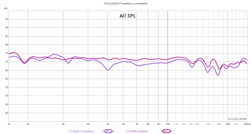

With Audyssey disabled:
I would say it sounded not as good to me, so I almost never watched movies without Audyssey enabled.
Anthem ARC Genesis is not very effective in terms of measured performance, but to my ears, it sounded good enough for me to also almost never watch movies without ARC G enabled.
Above are all from watching movies, I rarely listen to music on that system.
