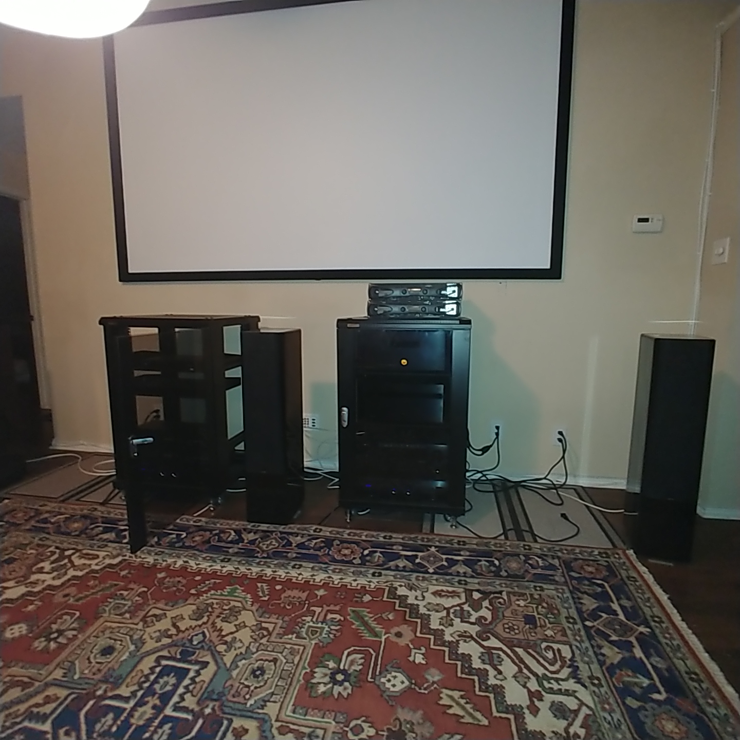

The amps are on top of the rack right now above the Emotiva amp could that be an issue? Here's a pic.
Can't really tell from a pic but move the amps onto the floor to test perhaps. I have a pair of 1500s that sit under an avr but with a fairly thick shelf in between....
