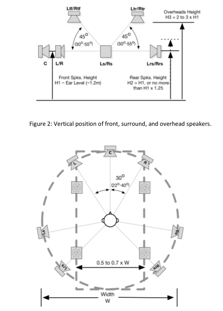

While I don’t think you’re miles off, the images here are a little rudimentary. I believe the angles are more important than the measurements.
https://www.dolby.com/us/en/technol...tmos-home-theater-installation-guidelines.pdf
This guide is much more comprehensive.
It also seems that keeping the “square” of atmos speakers above is more important than say, splitting the difference in a longer narrow room, and putting the front heights between the mains and LP. Again, this is in reference to the actual angled to the TF and TR speakers.
Yeah, these figures are just basic guidelines, definitely not meant to be exacting. :D
Most rooms are no bigger than 18 x 20 and many people sit a lot closer to the rear wall/surround speakers than the figures. :D
As you say, 2 ceiling speakers in front of you (close to 30-55 degrees) and 2 ceiling speakers in back of you are more important than the actual distance.

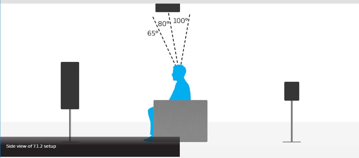

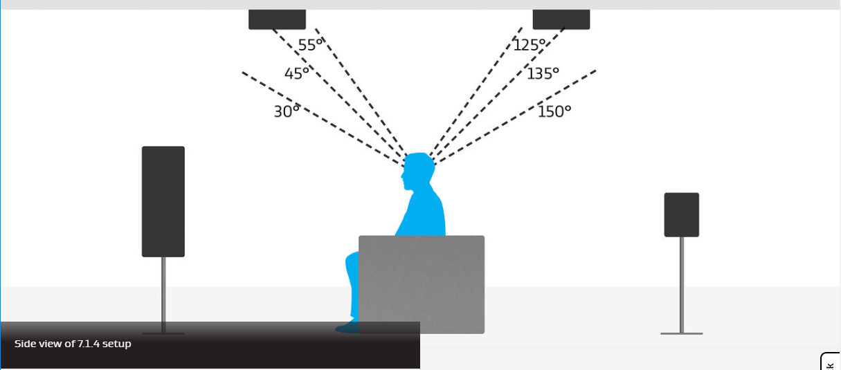

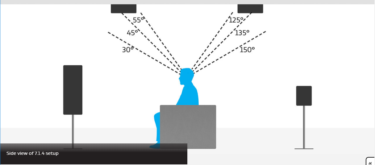

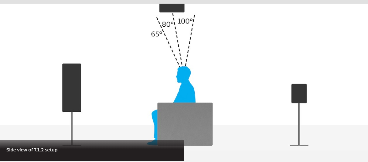

That picture is misleading. Dolby suggests using specific angles which really change where those speakers are going to end up. Especially with taller ceilings.
View attachment 25696View attachment 25697
Yeah that’s a pretty good “Guideline”. Something like that or close to it should be good.
A lot of people sit a lot closer to the back wall, don’t have as big of a room, have different ceiling heights (8’ to 16’). So a range of placements will work.
But these 2 pictures are a good starting point.
For 2 ceiling speakers, aim for 65-100 degrees. For 4 ceiling speakers, aim for 30-55 degrees.
But as we can see, there’s not much difference between 55 (4 OH) and 65 degrees (2 OH) - avg 60 degrees. :D
