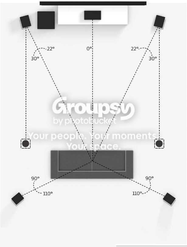

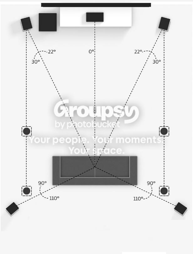

It seems ceiling Atmos Speakers are unequivocally preferred, but I’ve heard that Height Atmos Speakers are still better than no Atmos Speakers at all.
If you decide to try, the next dilemma is whether to go with 2 or 4 Atmos Speakers. :D
Question is, what’s the determining factor for choosing 2 vs 4?
Does it depend on how Dynamic your current speakers are? If your current speakers are so dynamic, will they overpower your Atmos Speakers?
Or If your Room is 15x17 or 18x20 or if your Ceiling is 8-9’ or 10-11’ or 12-14’ ?
Taller ceilings require more speakers than shorter ceilings?

My little room is short, only 8', but not too short horizontally, about 19'. I will definitely go with 4, because at the back I can place them on top of the tall book shelves and use the upfiring ones. If I place the front one as heights (ceiling for me would be too much work) I would still tell the AVR they are Atmos, I can live with telling white lies.:D
Definitely have to experiment to figure out which configurations sound the best.

Believe I’ll go 5.2.2, front heights, only cause I would have to move my sofa up 3 ft to have the rear surrounds done up right. That would put me about 5ft from the TV way to close! With that said, 5.1 which I’m running now still isn’t set the way I would like to. My rear speakers are off, right rear speaker is not set right it’s not where it should be. The room is weird.
Mike
Mike
I think 5.1.2 is more than enough for most systems.
I was going to only do 5.5.2, but my mains (SX-T2/R x 5) are just too overpowering for just 2 ceiling speakers in a 22' x 26' x 14' ceiling room.
If I could put 2 x SX-T1/R's in the Ceiling as my Atmos speakers, I would only do 5.5.2. :D

I think that would be a disservice to you and your system. You have an incredible stack of gear and IME , x.x.4 is much more immersive than .2.
Two overheads just can’t complete the bubble, or place objects behind.
It depends on the speakers and room size, doesn’t it?
It’s not just about the number of speakers, right?
Some speakers can project a much larger more expansive lifelike soundstage and image than many smaller speakers.
But I do get your point that having speakers both in Front and Behind you could produce a better soundstage and image.

You may have a point, really don’t need two Subs. I could do 5.1.4, front heights rear heights I believe I could make that work. I would have to have the rear heights firing down wouldn’t need to be very big speakers umm something alone a satellite speaker would probably work. Oh wait! I believe that’s called 9.1? Lol. Atmos and DTS-X here I come.
Mike
Mike
Yeah, do 5.1.4. I think it will work even if the satellite speakers are firing down. You don’t need to move the seats closer to your TV.
The .4 would be the Presence Height Front and Height Rear Speakers on the Yamaha AVR.
On my system, they are the Presence Ceiling Speakers.

Speakers and room size are always important of course. Quantity of speakers has historically been a questionable thing, but that’s always been based around channel based systems. In my own system for example, upscaling a 5.1 track via PLIIx to 7.1 does more harm than good. The performance of my 5ch configuration is much better and probably due to the speakers imaging capabilities. Still, no matter how good any speakers can image, two overheads just can’t do it as well as 4, and also consideration has to be taken to how the renderer distributes the content. With only 2 overheads, the metadata that’s sent to the rear OH speakers will be folded into the bed speakers so there is no way that even two of the “super mega bestest speakers ever” can do the same job.
I see your point.
Do you think going from x.x.2 to x.x.4 is like going from 5.1 to 7.1 to 9.1 ?
Drunkpenguin
I went with 4 right off the bat for one simple reason. If you go with 2 the placement is in a different part of the ceiling then going 4. So to start with 2 in-ceilings and then upgrade later to 4 either means patching holes or compromising placement.
