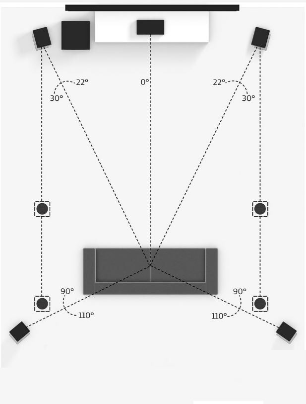

4&5 can be answered simultaneously. I have only used a 5.2.2 setup, but I have experimented with top front and front height placement, as well as "middle/side height" as well. In my experience, 5.1.2 really only works well when the speakers are placed in the middle position, at about 80-65 degrees of elevation. If it is impossible to install speakers in or on the ceiling, mounting speakers on the side walls and angling them towards the listener is the next best thing. The only way this might be a problem is if your room is extremely wide in comparison to the length, (for example, let's say your setup is on the long wall of a 25x15x8 room). You really want a minimum of 30-45 degrees elevation side to side or your brain will likely perceive them as just high surrounds. as far as front and rear heights go, i think they'd work fine so long as the system is a 4 height system.
As for the major difference between 2 and 4 overheads, the major downfall of having only two heights is a lack of front to back panning of overhead objects. 95% of the time this isn't noticeable, and mainly only applies to things like front to back flyovers.
6. I think sticking to the suggested layouts on dolby's website is the best practice, but myself and others will say, ANY atmos, even compromised atmos such as side heights, or (decent) modules is better than no atmos. Just use as many speakers as you can afford/fit and try to get them placed as closely to the recommended guidelines as possible.
