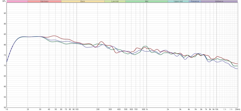

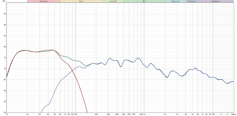

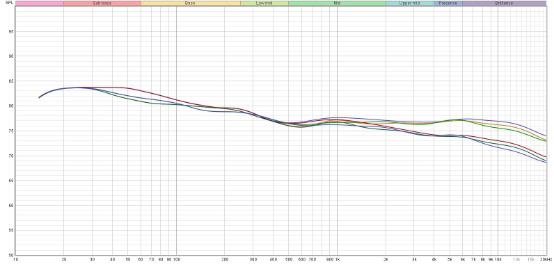

Finally got a chance to run some new measurement checks (trust, but verify :))
Although I'm probably tilting the response a little too much, I like using CinemaEQ with Reference. The Flat for some reason has a slight rising response so my choices are either not enough or too much; but this sounds good to me.
I used the smooth to overlay the differences between just Reference and then with CinemaEQ. Also did a check with just the Center channel (psychoacoustic smoothing).
