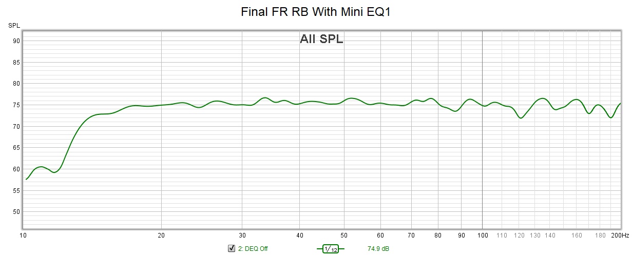

I spent this past weekend playing with ratbuddyssey to positive effect.
I think that's as good as I've ever seen from my system. I'm still using a MiniDSP from 90 hz and down, but used RB with the app editor above 90 hz. I found it tedious and time consuming, but effective. I don't think there's anything I couldn't do manually with the app that I can do manually with REW. I still prefer REW for ease of use and time involved, but I'm super tickled with what I was able to accomplish with RB and the app!
I officially love the app editor now and fully endorse it!

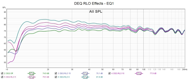

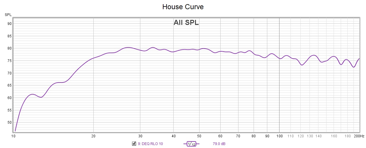

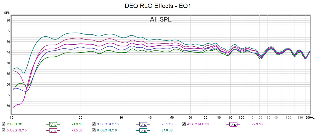

I use DEQ as my house curve. RLO 10.

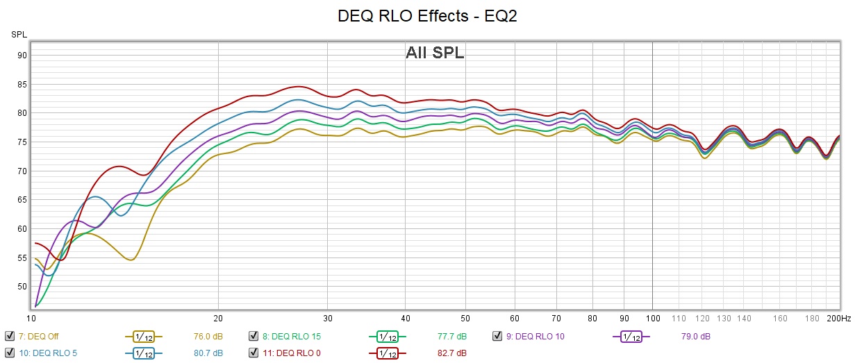

And I have options! For use here on the forums I labeled a couple more charts to illustrate effects of DEQ and the reference level offsets. Seems like it's come up a few times recently and these are a great visual.
It's also a great illustration of the 2 EQ settings with HSUs VTF series of subwoofers.
In the following graph the top line seems to be DEQ RLO 0. That is giving the max boost to bass. Is that correct.?
I thought that DEQ RLO 15 will give the max boost. Please comment.

That is correct. 0 gives the max boost and 15 is the softest.
I used the 90° calibration file with my mic pointed up at the ceiling.

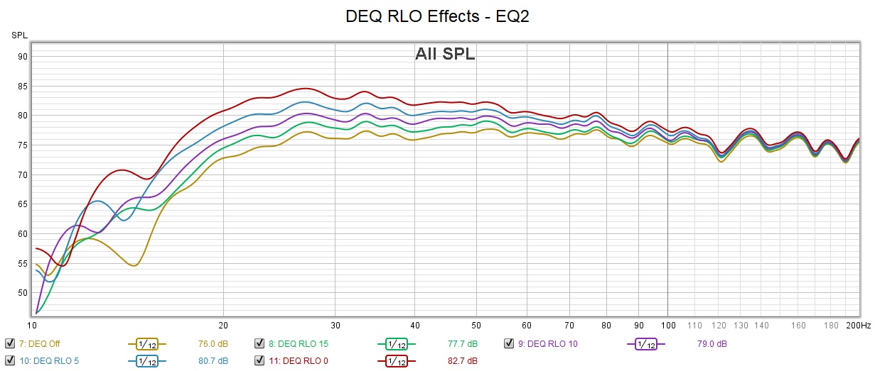

I will add that, despite EQ 1 having deeper extension I prefer the higher output in the audible range with eq 2 for music. It just sounds better to me. More impact and chest thump.
RLO 10 for music and RLO 0 for movies. If it's a movie that I know has a lot of really deep bass then I might flip to eq 1 and plug a port just for fun.

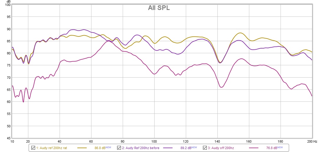

Ok. So here is to 200hz. Crossover is set to 200hz for testing. This is mains + subs. Purple is before tweaking with ratbuddyssey, gold after. Purple is audyssey off.
Minor improvements, but 140hz has a big dip I can't get rid of.
That gold trace is looking pretty good. At least you're making some improvements! 200 hz seems awfully high for a crossover tho, and that dip at 140-ish is probably a room mode that won't be easy to fix with PEQ. Did you try giving it a bump with the editor?
You can also try moving stuff around a little to see if you can improve anything before running room correction or applying any eq. I did sweeps of my R and L mains individually, as well as my subs individually. That helped me zero in on a huge null on my right side. It's there with the both the speaker and sub on that side. I have a little bit of wiggle room so I moved the speaker 6" closer, take a sweep, moved it 6" the other way, 'nother sweep, repeat. Did that until I found a spot that wasn't too out of place and also gained me back just a couple dB. Didn't seem like much but when I ran Audyssey again it did a much better job.

It looks like 85 dB is your target? If so you can go through and make some cuts on those high spots and it'll make those dips look a lot better. Sometimes a cut can have positive effects up or downstream too. It can also have deleterious effects too tho, so that's why I only tweak one thing at a time. If you upload multiple adjustments and something goes south you don't know which tweak did what.
This is why I still keep my mini inline. It is so much faster to do a 10 second sweep and make an instant adjustment. No uploading and emailing files back and forth. I like that I have the editor tho, and ratbuddyssey definitely helped and is effective. I just wish it weren't so time consuming. Using it I spend more time staring at a black screen waiting for the upload to finish than I do measuring and adjusting.
I'm maxxed at 140 so like you said, not much to do there. I'm more concerned about the crossover because, like you said, 200 is really high. At 80 my sub 200hz response looks worse. I'm going to play around a bit more, but I need to get the rear subs done so I don't have to start over after a lot of work.
