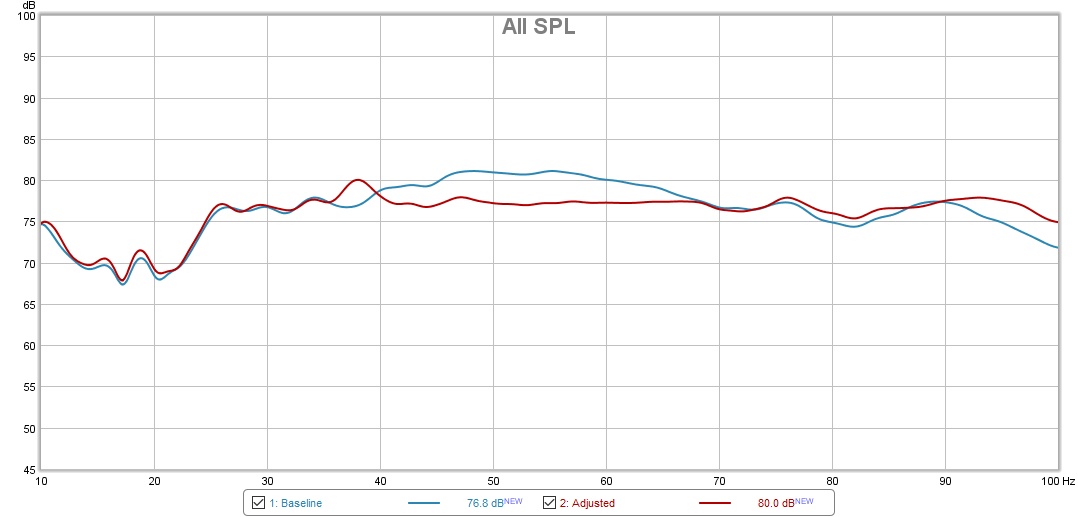

Followed @PENG instructions and it did well. I'll keep on playing around, but it doesn't seem to be able to trim as much as I'd like it to. I was going for 70db as my baseline.
Before and after adjustments below. I used the frequencies in the spreadsheet just to keep it simple for this experiment.
With the current settings, 75-77 dB would seem to be more realistic to reach in my opinion.

Looked at you ref and off curve again, I would aim for 78 to 80 dB spl.

Attempt #2. I set my base db to 78 this time. MUCH close to the 75 mark, but it is getting better. This is sort of addicting... Spreadsheet makes for easy adjustments since I just have to change one number. I do need to look at toning down the boost at a few frequencies though.
That is much better than with the first attempt. I think that the aim should be kept to 75 dB now. Let's see what @PENG will say.
panteragstk
panteragstk
I agree. Just going to have to forget about below 25hz for now. It's interesting that targeting 78 dB got me very close to the 75 dB goal.
It really is! Folks give me crap because I'm never completely satisfied and always messing with it. It's not that I think what I have isn't good, it's just... kinda fun. I genuinely have fun with it. I have some ocd tendencies and this kind of thing feeds right into it.
PENG
So it didn't take long you see..... You have it very close to flat now so two things to consider:
1) Any further improvement for even 0.5 dB peak to peak overall will take you 10 to 100X longer, just an educated guess.
2) You won't be able to tell a difference between +/- 1.0 dB and +/- 2.5 dB in the 20-100 Hz range if you are human.
3) Try and create your "house" curve, or just bump you subwoofer level(s) by 2 dB and see if that sounds good enough to me.
I tried to tilt the low end up per Dr. Olive and Dr. Toole's finding that most people don't prefer flat, but a gradual rise towards the low end. Well now I know I am definitely not in the "most" group as I seem to prefer the flat curve though I always use DEQ if I listen to levels well below "ref". If I turn the volume to even just -10--15, I have to turn DEQ off otherwise someone in he house will want to kill me anyway.
So 3) is probably something that you should just try. The good thing with the App is that you can save as many versions as you practically would want/need.

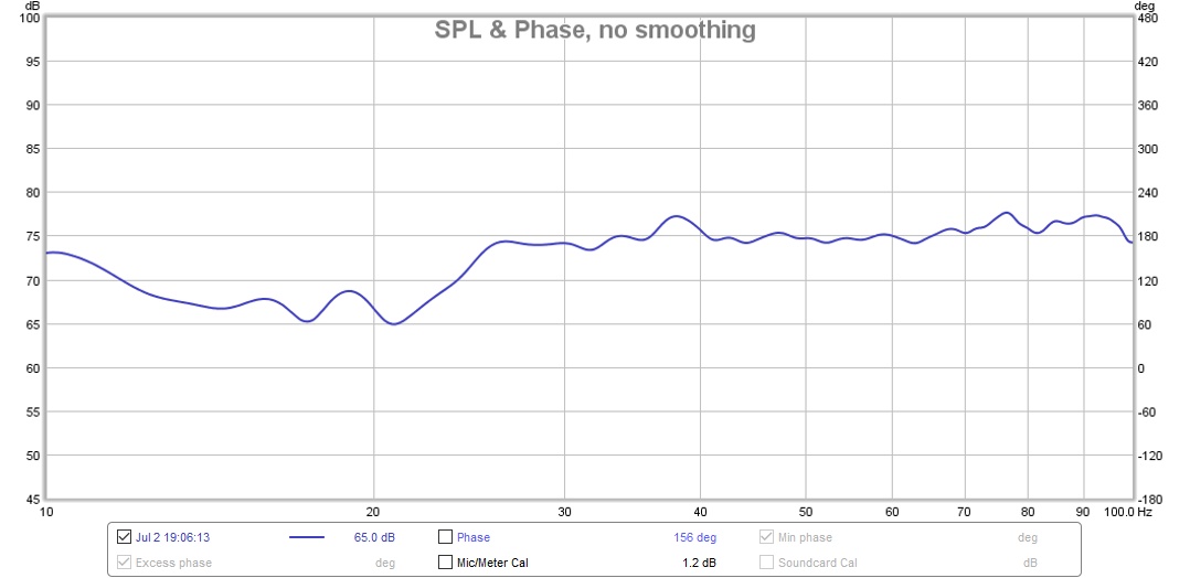

I've said it before, DEQ is my house curve. I go for as flat as possible then use the tuning options on my subs and DEQ.
