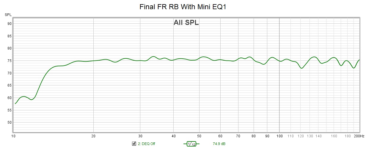

I spent this past weekend playing with ratbuddyssey to positive effect.
I think that's as good as I've ever seen from my system. I'm still using a MiniDSP from 90 hz and down, but used RB with the app editor above 90 hz. I found it tedious and time consuming, but effective. I don't think there's anything I couldn't do manually with the app that I can do manually with REW. I still prefer REW for ease of use and time involved, but I'm super tickled with what I was able to accomplish with RB and the app!
I officially love the app editor now and fully endorse it!

That looks really good for up to 200 Hz!! Again, beware that if you want to do better, even with Ratbuddyssey it will take infinitely more trial and error. I did it only for fun, not for audibly better sound as it ain't going to happen. No one can tell the difference between +/- 0.8 dB and +/- 1.5 dB in the 20-200 Hz range. Best I managed so far was about +/- 0.8 dB 1/12 smoothing or +/- 1 to 1.5 dB no smoothing. I have started working on a house curve but so far I have to admit, the very flat curve suit me just fine. I know now I am not a certified bassholic,:p probably not certifiable at all.
