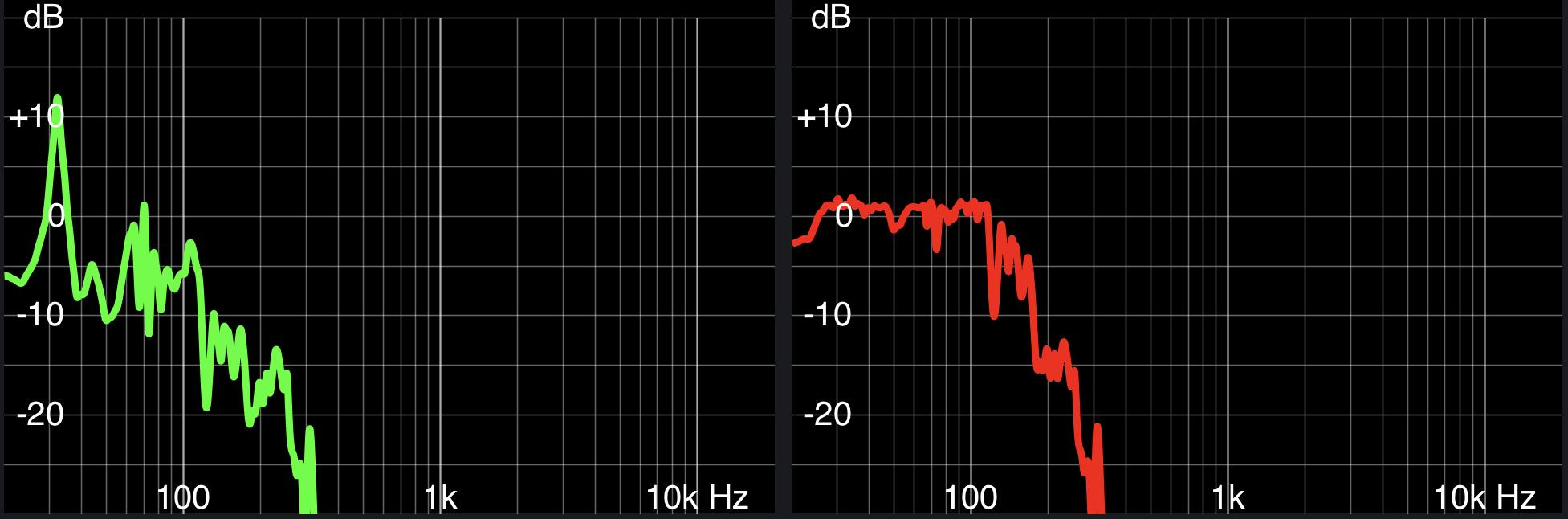

Thank you again. I repositioned my sub last night. Moving it all around the room and measuring the low frequencies. Found a better position at the front of the space where the 60hz null dissipated significantly, at the cost of it being a little less flat from 20-50 (still peaks though, not severe dips).
The measurements you were looking at are with toe in where drivers were pointed almost directly at mic (slightly behind). Mic was pointed center between speakers. Listening Position is about 7-8' back and speakers are 7' apart. Could too much toe in cause issues in that 10-20k? I also wonder if that roll off is just room issues and measuring from further out.
PENG
It just does not look right to me with that kind of roll off especially for a short 8 ft distance as the R162 supposedly has reasonably good off axis response. Does the curve look like that too with fixed smoothing of say 1/12th? You may also try removing the grille in case they may be the problem.
Note that if you prefer the so called "warm sounding" kind of signature then you may be good the way it is already.:) Almost forgot, did you plot those graphs using the reference curve or flat. If reference, you can try flat and you should get less drop off in the highs. Audyssey used to say the flat can be used in a smaller room, otherwise stick with reference. That obviously should not have made a difference if you set the EQ limit to <300 Hz (I thought you mentioned something like that), but in that case please double to make sure you have not forgotten to set the limit to both speakers.

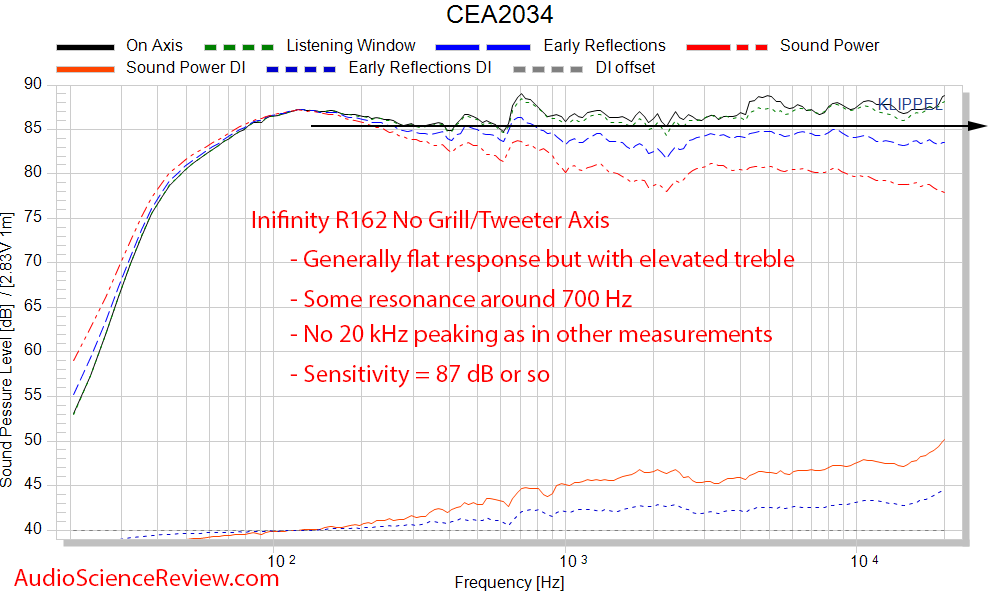

Below is what ASR found:
Infinity R162 Bookshelf Speaker Review | Audio Science Review (ASR) Forum
The measurements were actually for the new Sierra 1s, but same thing applies. MultEQ only allows me to set frequency range for "Front". I don't think it breaks down left and right when I drag the limit line.
The room was also measured "as is" and I do have a coffee table that is kind of in the line of fire. Curves were plotted using reference (below 300hz).
