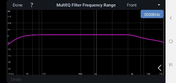

My frequency range slider won't move. Is there a trick to slide it? I'm putting my finger on that arrow, and trying to slide it, but nothing happens. I'm using a Note 10 Plus if that matters.

Apparently, there is an issue with the Samsung Galaxy 10+ that may also affect your Note 10. Here is a workaround you could try. I don't have a 10 (Note 9 here, no issue using the slider) so can't try it myself.
Go to settings --> full screen apps --> advanced settings --> tap 3 dots in top right of screen --> hide front camera. See if you can move the slider. If you then change the setting back to allow the front camera the slider is still adjustable.
I actually got it working. I have to tap on the number, and I can see it shift a little, then I'm able to drag it. Thanks though ! One last question. I see a lot of people like to set it to 500. Do we do that for all the speakers, except the sub?

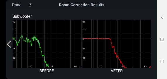

I did the sub crawl, and put my 2 subs in the best spots. This is pretty good, right?
