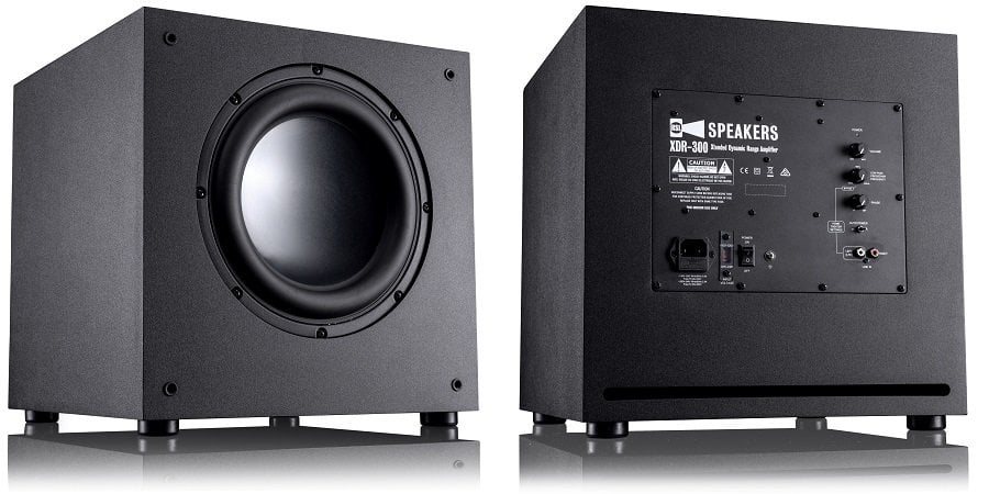

TLS Guy Audioholic Jedi Oct 30, 2007 27,303 0 113 79 Eagan MN Aug 14, 2024 #20 flippo said: I will Probably Stick with what I have till it breaks. TY everybody! Click to expand... That driver I selected is a dead ringer looser. So stay away from that, it did not model well at all. However I had a design on file that will make an excellent sub. The driver is the Dayton RSS15HF-4 12" from their reference series. The vents are on the long side, so you will either need a bend in them of put them vertically and have then exit from the bottom of the enclosure. This should be an excellent sub and be very good for classical music, as I don't use extended bass alignements to get a two or three lower Hz on the bottom end. Attachments Dayton RSS315HF vented BB6. (1).pdf Dayton RSS315HF vented BB6. (1).pdf 326 KB · Views: 381 Reactions: MrBoat
