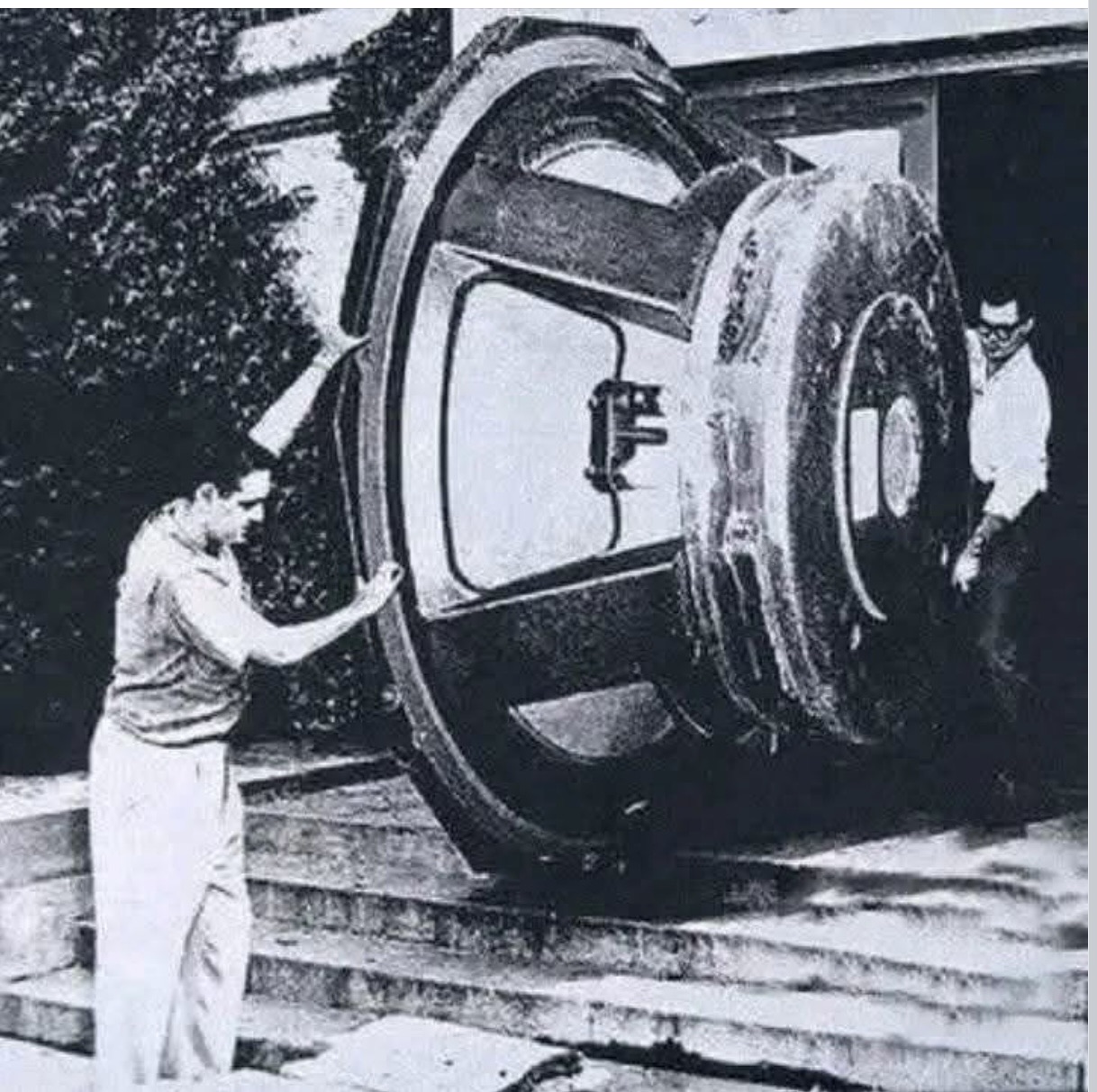

Honey the subwoofer isn’t too big, the house is too small. You hold the door.
