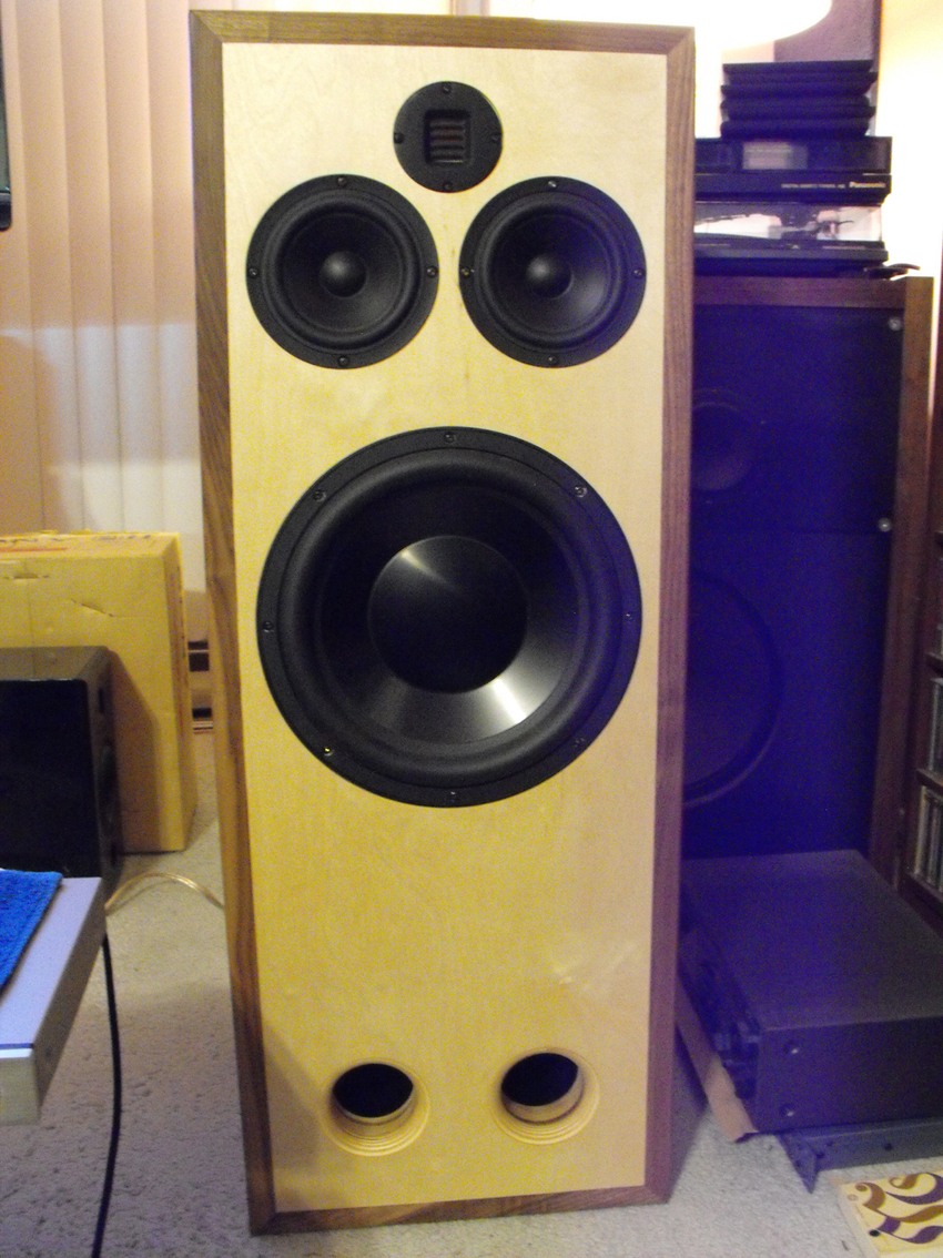

IMO, the RSS315HF sub is definitely a better musical sub. Dayton sells it as a Hi-Fi driver. Several years ago, I built a pair of enclosures using that RSS driver as the woofer in a 3-way system. The performance was really outstanding and well reviewed by some serious audiophiles:
Yeah, they sound pretty amazing as is. I just have the Ultimax driver already so it's just something else audio to play with.
