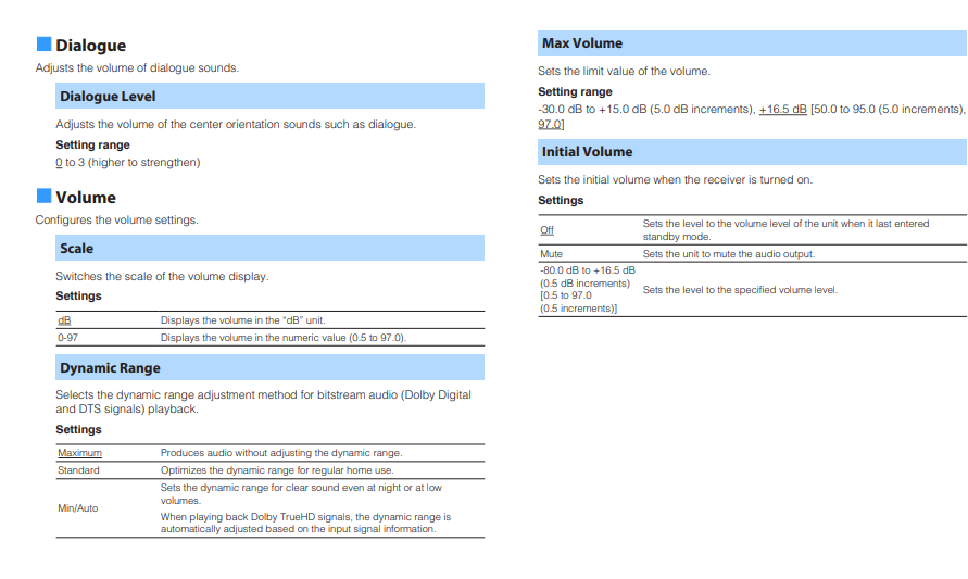

Would this do the job?
here is a snippet from the manual, it doesnt seem the dynamic range is something i can control just presets so I would have to hope it does the job>? Or , to the right, MAX VOLUME , would this allow me listen at the volume i like for dialogue and any background / action scenes will be capped?

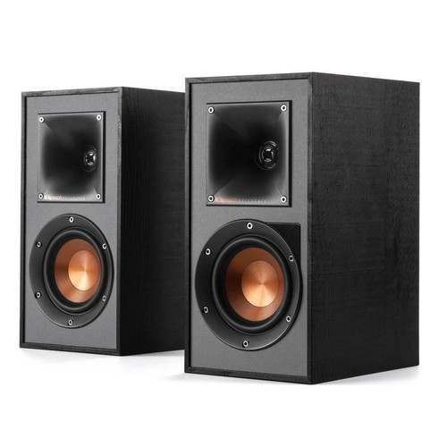

was thinking of these as some speakers

The Yamaha avr would be fine. The max volume setting is just that, a limit as to how far the volume can be turned up (especially handy when kids are around or used by people not familiar with the gear), or sort of a save-yourself type setting :). That avr does have some adjustability for its dynamic range routine (many do). Not a fan of Klipsch particularly myself, particularly such small speakers (they're more similar to the size found in sound bars) but I'd try and get to listen to them before buying to make sure they sound good to you, but I'd also try some larger models.
ps as everettT points out, the avr would be good for passive speakers (i.e. speakers without their own amp), not active speakers, due lack of pre-outs (pre-amplifier outputs) on the avr. Klipsch makes both passive and active/powered speakers.

You can't use powered speakers with that AVR, it has no analog or digital outputs. Passive speakers would be needed with that unit. I'll take a look at whats available used. What area are you in to get an idea about shipping?

You can use powered speakers with that AVR, it has no analog or digital outputs. Passive speakers would be needed with that unit. I'll take a look at whats available used. What area are you in to get an idea about shipping?

Sorry didnt quite understand that reply are you saying the avr and speakers i posted wouldnt work together?>
yes so the dynamic range seems to just have options similar to setting night mode on a sound bar, which doesnt work on a sound bar so dont see why it would here.
Some avrs have a full set of pre-outs for all channels, some are limited to just a few channels (2 main channels as well as subs on the Marantz Slimline avrs TLS mentioned), some just have them for subs. Generallly for a full set of pre-outs you will need a higher end model avr, tho. Some speakers have their own amps built in (called active or powered speakers), and can work on pre-outs from an avr, some speakers have no amps of their own and rely on the amps built into the avr.
As to dynamic range working on an avr, I have several avrs and the dynamic range controls tend to work well enough (altho I don't use them....but am not dealing with varying volume levels during a given show particularly myself). I think perhaps better speakers would simply resolve some of your issues, tho.
