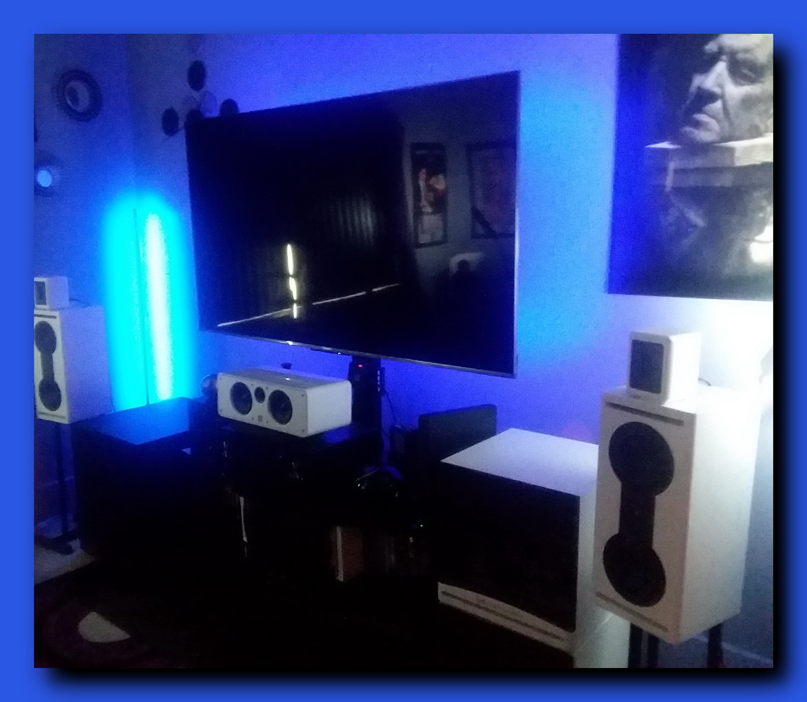

Nice setup! What speakers and center are you using? Are those tweets on top?
Thanks....the Center is a Q Acoustics Concept. I have an RSL CG25 for a center also underneath my AVR, I just like the Q better for center duty.
Mains are RSL CG25's (sometimes CG5's) with Aperion MKII Planar Super Tweeters on top....I like a little more high end "air"
Surrounds are my Q Acoustic 3030i's.
I have a Speedwoofer 10s MK2 that I'm not using....bass is just ridiculous in my small room with a 12S and two 10S MK1's going together....
All my speakers are white, except for the new Speedwoofer 12S...but some roll on white epoxy paint will cure that!
Sometimes I play with Atmos, usually deciding its not worth the trouble....maybe in a bigger room.
