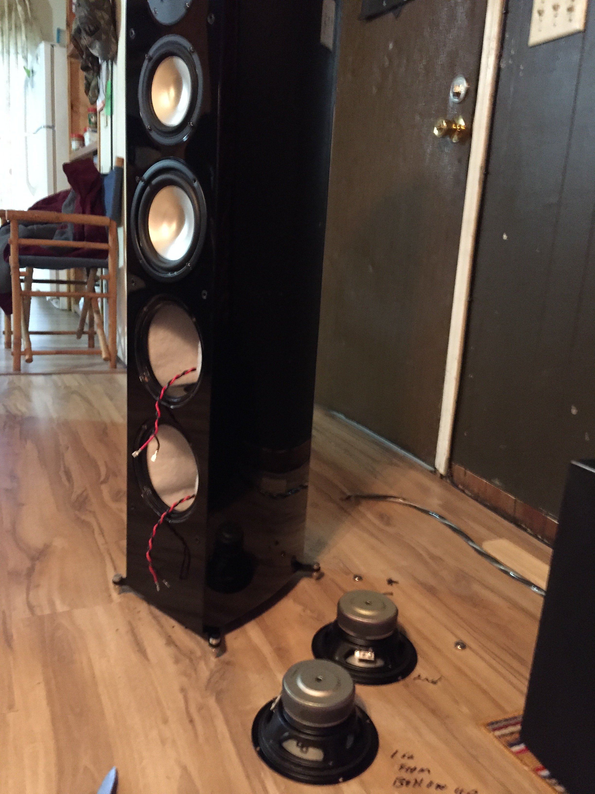

Gene, morning to You! Here are some photos of what I have found since some of the members think I out my mind. At Daren’s Request I crimped down on all 10 of the oversized Negative - connectors on all 10 drivers. Now only the Center channel had the right size Connect to the two drivers and the tweeter. Here are photos of my left front Tower. I was Absolutely disgusted when I discovered that the negative side on all the drivers female connector had been replaced. Daren went as far as asking me to Solder the oversized Wrong connectors to the drivers. Can you believe someone who Represents RBHSound would even Recommend !! such a thing! This dude is a Marketing sales manager at that!! I m at a Crossroads with this. PS, my Son helped me with the right side Tower, at my age 60 I needed his help. So he Witnessed the wrong oversized - connectors on the Righr front Towers. At lease I got to spend time with him and my grandson.
Mike View attachment 26614
I'm surprised they would suggest soldiering the connections!
However, I would also hope if you told them you were not comfortable opening the speakers, they would give you an RMA and take care of the problem for you.
This looks like China QC issues. It is not uncommon to see a different part being substituted to keep production going when they run out of the proper item. The idea of stopping the production line to fix a problem does not mesh well with the Chinese tradition of not causing any problem for your boss and being clever to solve the problem without disturbing them!

I told Daren that very same thing, that I was Afraid of scratching the towers. On my left tower the top driver is Damaged from me trying to pry it out of the cabinet. Gene doesn’t think that Daren would even Recommend something like that soldering the leads to the damn speakers!! But he did ask me if I know how to solder. Told him I wouldn’t do that. Now I’ve posted up some False facts just to see what kind of feedback I would get. I had Matthew come over to my home to help me pull out All of the drivers from the right Tower and sure Enough the - negative leads to each driver where oversized very loose. On my left the 2nd from top the - lead wasn’t even on the - Negative side to the driver. Center channel I pulled two drivers tweeter and one 5 1/2 driver they have the Factory connectors. They have the clear sleeves on both -/+ female connectors. Anyways like Gene said I cut my lost was going to get a RBH sub and surrounds and back surrounds. With this “Hobby” isn’t the first or won’t be my last on cutting a cord.

Guessing he drove them hard then started to hear problems as the vibrations caused the loose connections to lessen contact. His first reflex was that he had damaged them and upon disassembly, he discovered the loose wires.
...Came up to about 220 bucks. That I would pay. Cause I Thought I had damage the drivers. But when I pulled the lowest driver and saw the oversized negative leads “females“ I stopped and text ADGT about that Issue...
