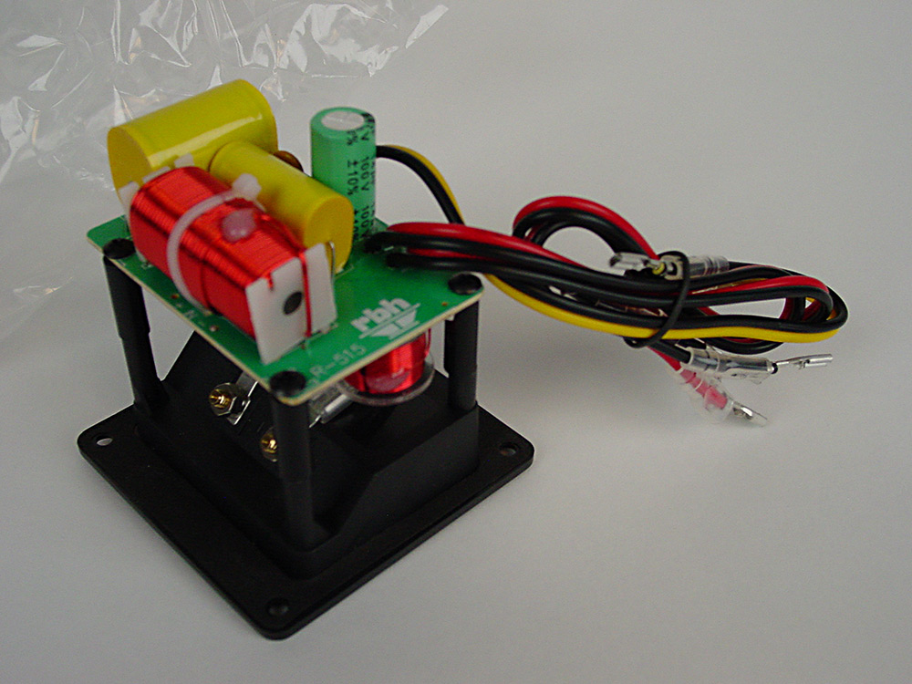

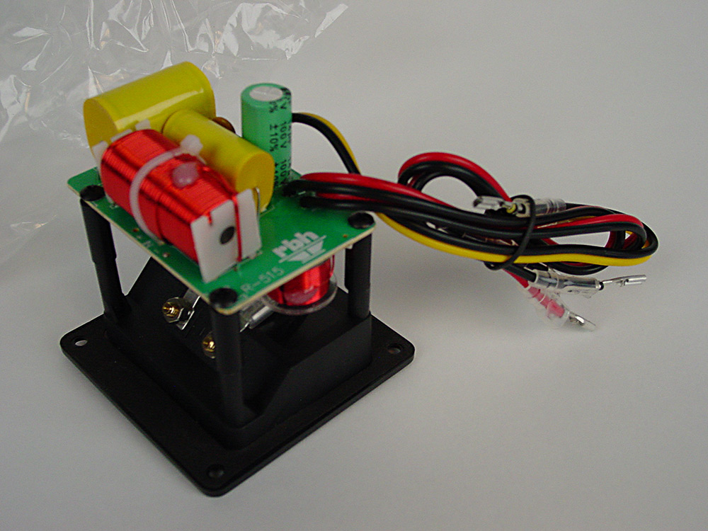

This is the R-515 & R-515E crossover

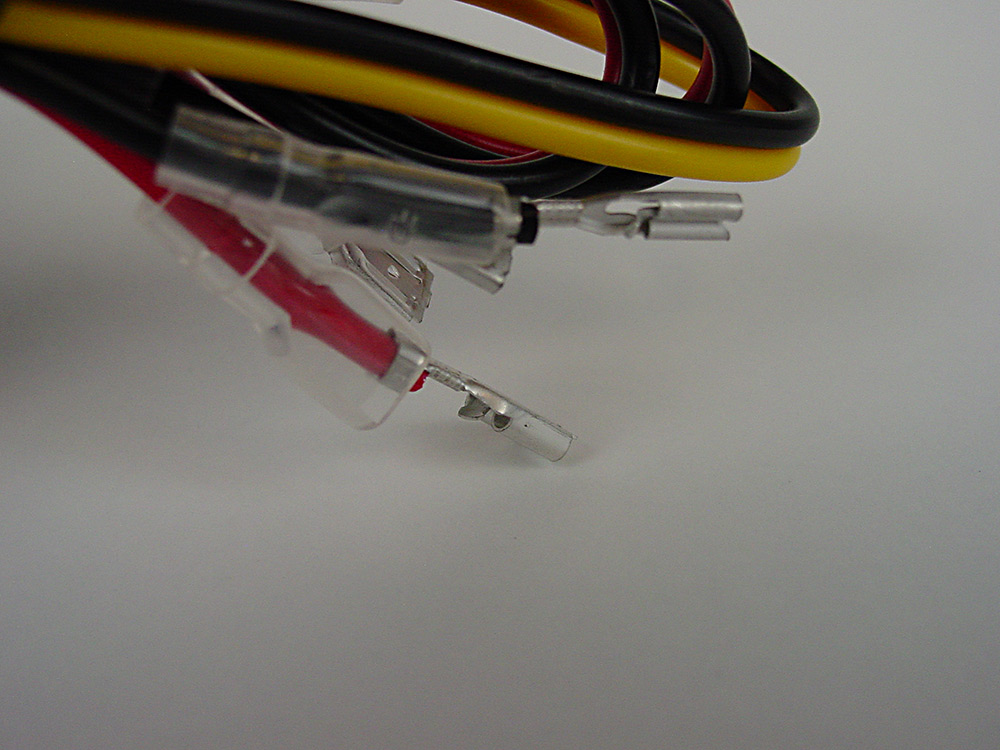

These are the terminals Carl is claiming are the factory terminals. Note the rubber insulators (not included on the R-55 & R-55E crossovers).

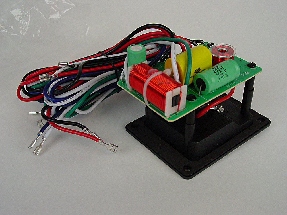

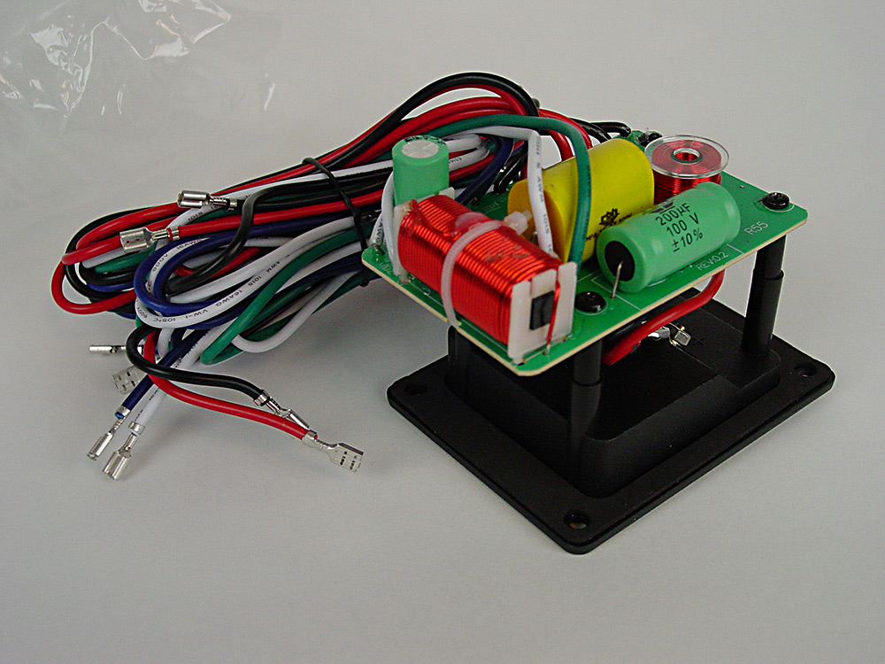

This is the R-55 & R-55E crossover.

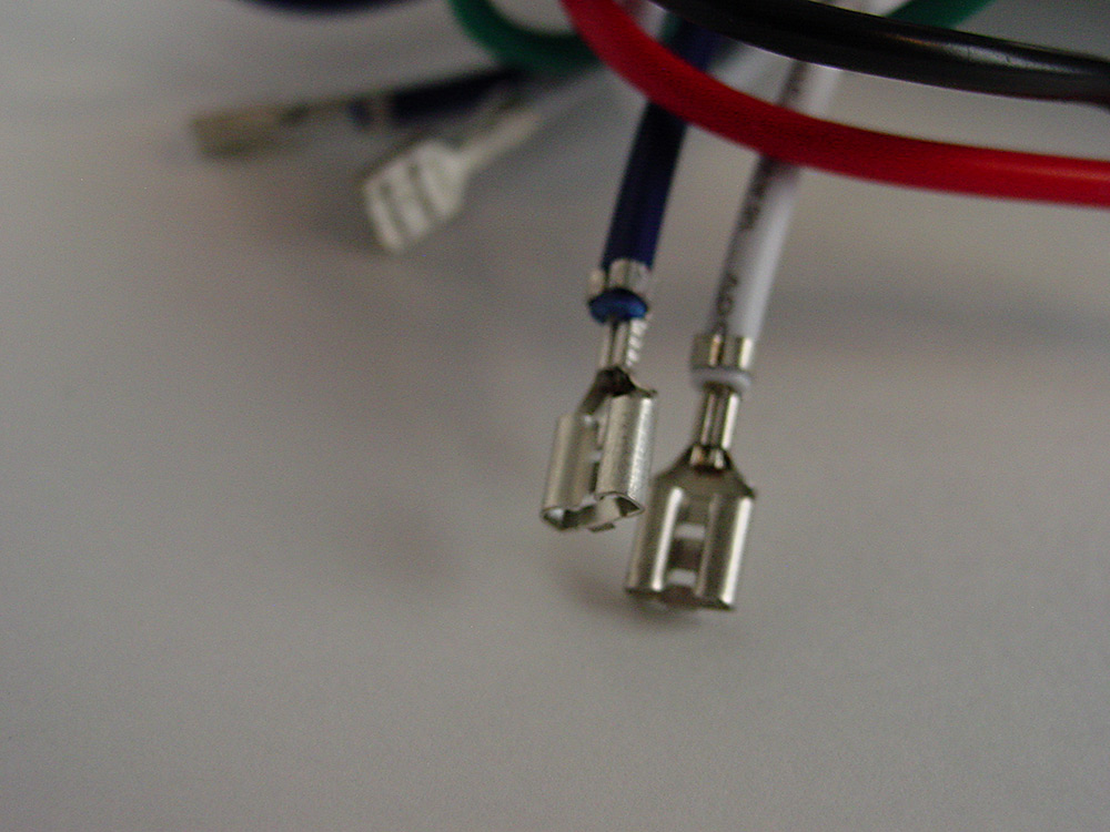

Note the same-sized connectors (without rubber shields) for the blue and white mid-woofer connections.
