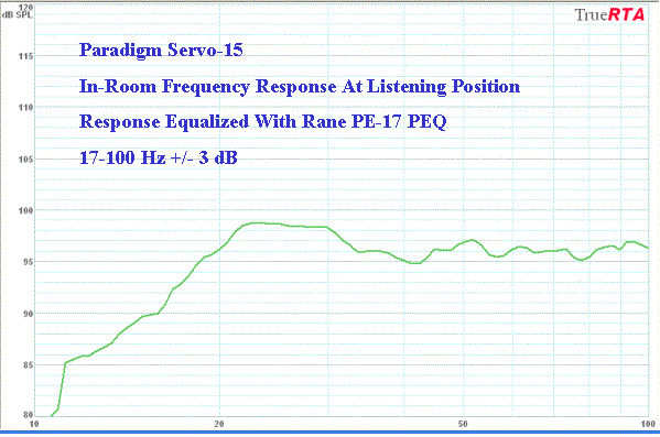

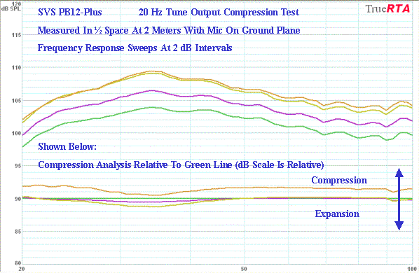

And to prove my point from above, I give you in-room responses of the Servo-15V2 and the PB-12plus (with the 12.2 driver, not 12.3).
Both reviews were conducted in the same manner by the same person.
Here is the Servo-15V2s in-room response.
And here is the PB-12plus.
Note how the Servo-15V2 is using an outboard EQ, while the SVS is using the built in single band parametric EQ.
EDIT: Hm, the SVS picture won't appear. Just click it to see the graph.
Yes a frequency sweep is one of many ways to determine the performance of a subwoofer.
Overall it looks like the Servo received better scores.

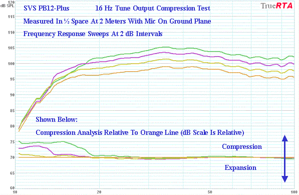

The SPL's are higher at the lowest frequencies tested on the Servo as well.
The 16Hz port did test favourably against either the 20Hz port or Servo in the output compression test. One might think not at first glance, but the 16Hz port graph ends at the 10Hz mark. HOWEVER the overall output is not matching that of the Servo and doesn't even get above 105dB.
16Hz
20Hz
Servo
Ed also keeps the testing limited on the SVS at 10% THD. He also has this to say.
While there is debate over distortion audibility thresholds, my own experience indicates that THD exceeding 10% will cause audible doubling, a loss of clarity, and noticeable pitch shifting during normal music and movie playback.
When you look at the graphs on AV Talk you can see that the THD for the PB12 hits 14% at 20Hz and 100dB, skyrocketing way above that at 105dB to over 30%. It's audible, but less noticeable in movies than in music.
