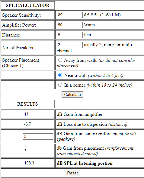

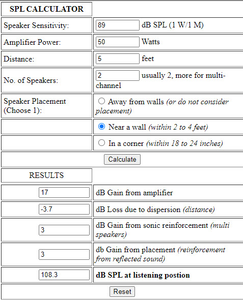

We don't need to overthink this as @Rylan said he can only afford a small Amp. It sounds like the need is for an Amp to power a pair of RSL C34E MK2 Atmos speakers (for now). Their Specs say:
  • Sensitivity: 89dB SPL (1W/1M)
  • Recommended Amplifier Power: 25 – 150 watts
I have no good references for Atmos Speaker needs but I'd guess 50 – 75 watts would be sufficient. Perhaps another member can chime in with real data.
I did a little work on an SPL Calculator using the above Data and the previous distance info @Rylan provided. I then arbitrarily plugged in a 50 watt Amplifier Power and the resulting SPL at the listening position is over 108 dB!
Accepted guidelines for recommended permissible exposure time for continuous time weighted average noise, according to NIOSH-AINSI and CDC, before Hearing Damage occurs for 106 dB is <4 minutes. For 109 dB it's less than 2 so I'd guess at 108 dB it's less than 3 minutes.
So I don't think you'd go anywhere near that loud even if the 34E Mk2's can get there. So I'd be looking for a 50 Watt per channel Amp. I'm wondering if one of those little Class D amps from Fosi (?) would suffice.
I hope this is helpful.
