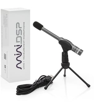

Found out the Umm6 mic is a USB mic, which will work great for REW (when I eventually get around to trying that out)
I purchased it thinking I could also use it with my Denon for calibration. Looks like I only have the 3.5mm option for the Denon mic. If I’m going to eventually use the Umm6 with REW, is it worth it for me to purchase an additional mic (one that’s better than the Denon mic) or is that not needed?
Ok, I’ll do that. I got a new umm-6 mic I can now try out too
The usb mics do beat hell out of the old ones you had to fiddle around with providing power to. The setup/calibration mic is compatible with the avr, the usb mic would be a separate use (like general measurements, seeing results of your setup as done with the avr's mic/program. With the usb mic you can use your laptop and something like REW (Room EQ Wizard) to check results of setup/calibration, tho. While REW does have ability to create/load certain eq, avrs generally don't have a way to accept such.
ban25
ban25
Note that if you buy Dirac for the new Denons, you do in fact need a USB UMIK-1.
It may. Dirac's recommendation is the UMIK-1:
Not much to go on but imagine something like the Dayton mics with calibration files would also work. They do in REW.
