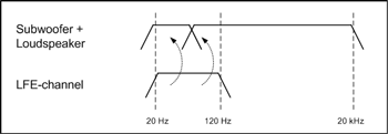

So the crossover, or XO, is the point at which the avr transitions from sending content from the speaker to the subwoofer. The “woofer” in almost all speakers is passive, and powered by the avr, which you’ve picked up on. The subwoofer is powered by itself but content is still sent from the avr, which due to its design is only bass and midbass.
Think of the frequency range being divided into two parts. High and low. Speakers are responsible for the high, and subs are responsible for the low.
Imaging a piano being played through your system starting at the very top twinkly keys and working your way down to the left. When you get to the last 1/3(example) that’s where the avr would start sending content to the sub. This XO is not a brick wall, but slopes down above and below that point.
Maybe this will help
(disregard the LFE section in the pic, just for now)

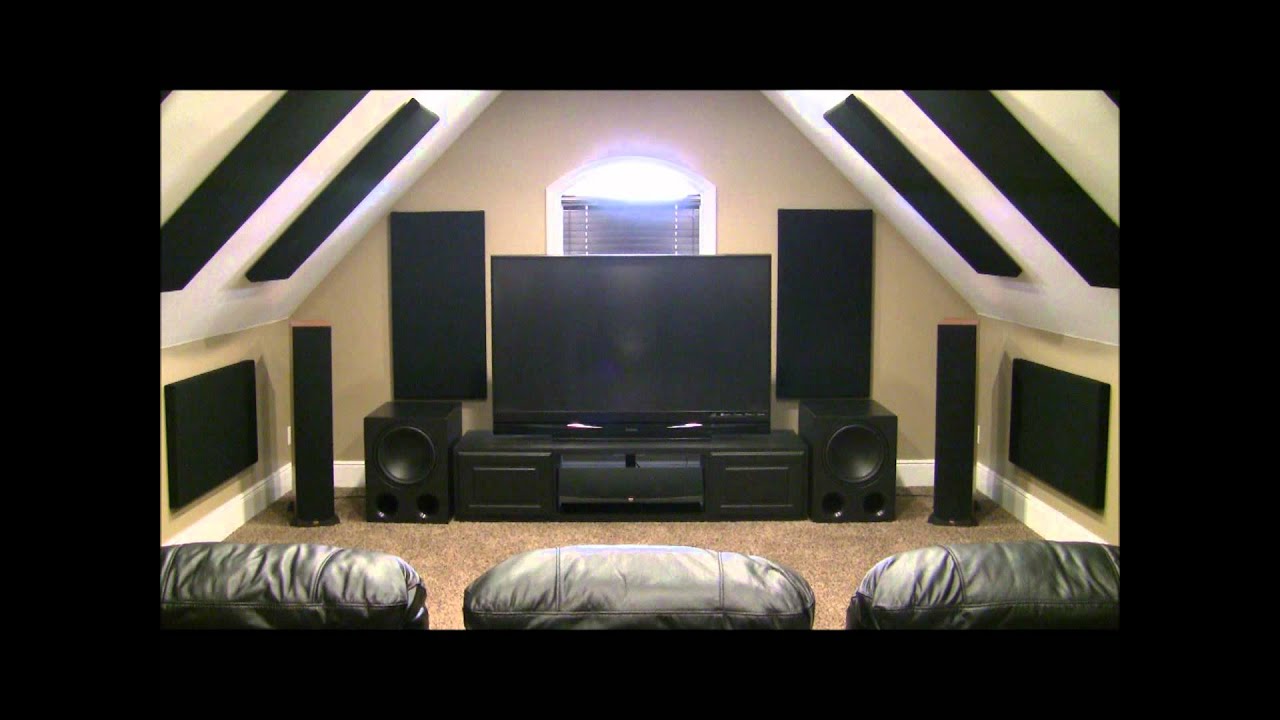

Btw, if you’re preference is really to keep the layout how it is. Then I would also move the couch ahead a couple feet, and then put surround speakers on stands in their proper locations. Plenty of available, IW/IC(in wall, in ceiling) speakers to do Atmos with. Shady listed the usual suspects for speakers, and they all have something good to choose.
