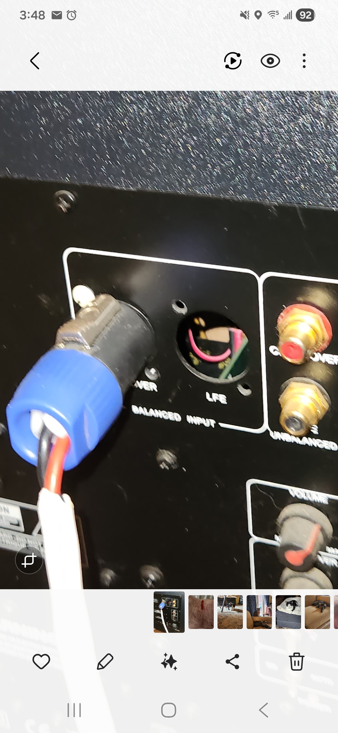

Well, one sub anp on an Epik Empire failed, and the company was gone. I just used a crown amp to power it and I actually have better performance with my DSP. If I could have found a direct replacement or anything close to fitting, I would have.
How did you bypass the sub-amp and connect to the Crown?
Was there a pre-out on the sub amp to allow bypassing the sub amp?
Simple, I pulled the amp and wired the crown through the existing opening to the xlr input, could have done it through the rca but it was easier than the rca input, just easier that way.Just took advantage of what was there.
