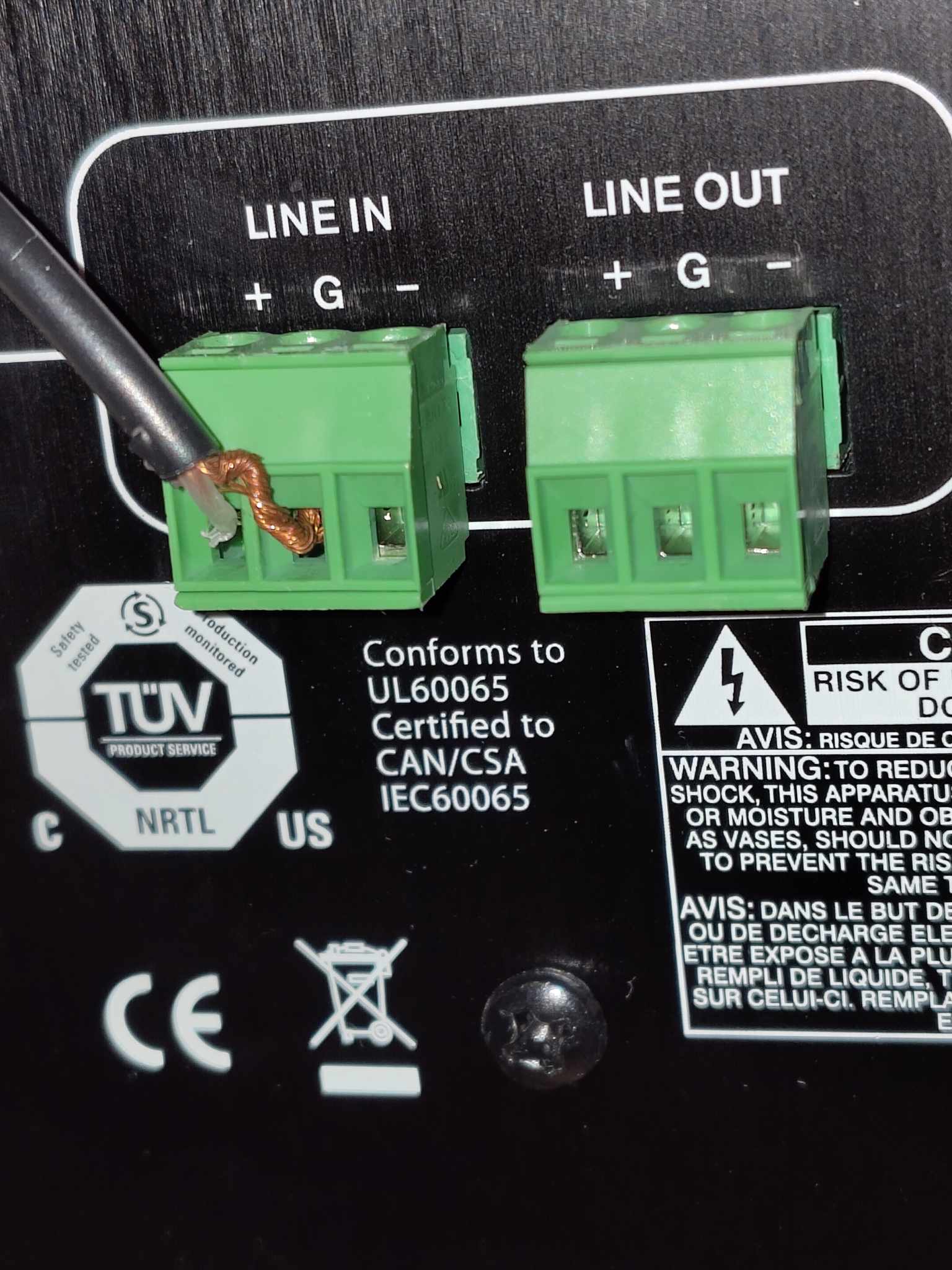

I have replaced the power cable for the woofer as it looked a bit knackered. No change. Replacing the audio cable looks to be a pain as it is RCA to phoenix. I have included a photo of what the connection looks like. I bought this woofer secondhand so this is not my work. As a noob to all this, I have no idea whether this looks like a solid job or a total mess.
Thanks in advance.
That looks like a 75 ohm coax tv cable going into that connector....that surely cant work well.
Do you have the other end plugged into the Yamaha sub out ?
I would bet that sub isn't meant to be used outside of its mother system.
As it is, I'm surprised it works at all...thats a speaker level input you have plugged in to.

You can't use that sub with that receiver. You need a different sub.
Eppie
