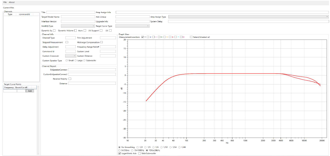

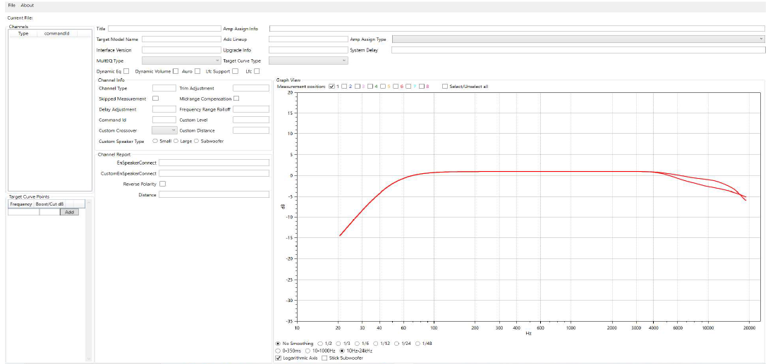

To download the Ratbuddyssey UI:
After that, focus on post#144, https://forums.audioholics.com/forums/threads/the-audyssey-multeq-editor-app-users-thread-with-facts-and-tips.118005/page-8#post-1401884

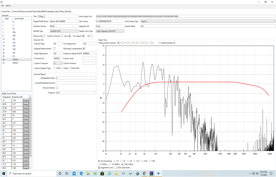

It is my worked example:
I copied/pasted the interface below:
The bottom left table is where you would type in the boosts (+ve) and cuts (-ve) for each frequency. When you are done, you can save the file and send it to your device using the "shared" function iirc, or copy it to the smart device appropriate folder. Let me know when you are ready so I can post some screenshots you can follow. I haven't done it for a while so I will need a few minutes to recall how to do that, but rest assure it is easy to do.
The AVS thread has much more information, but I thought it may be too much, 32 pages, 633 posts and counting.:D

Is it the ratbuddyssey application i want to get in or ratbuddyssey.exe.config or ratbuddyssey.exe.manifest?
PENG
Neither, use the one named "Ratbuddyssey.exe".

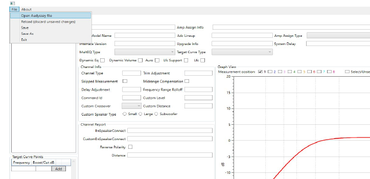

Double click it you will see the following opened up:

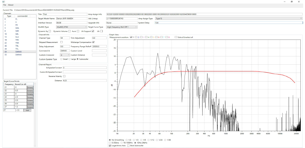

At the left hand bottom corner is the little text box where you enter the frequency and boosts/cuts you want to apply.
For your first trial, I suggested you focus on between 20 to 27 Hz, apply the cuts that you can see from your REW graphs that is needed at say 21, 22, 23, through 27 Hz to flatten it.
After that, save the file, give it a name. Then you can copy the .ady file to the MultEQEditor folder in your Android device. You can do the same (but different way obviously) with an IOS device too obviously. Once that's done, next time you open the App on your smart tablet/phone you should be able to see the new target curve shows up. To make it easy to ID, name it in a way that it will look obvious to you hat it is the new target curve you created.
Before you send it to the AVR, you can select that curve and see how it looks like.

Ok I finally got it up. Do I need to fill in all the boxes or just where the cutting and boosting boxes are?

And how do I get more boxes to appear so I can enter the rest of the frequencies, it’s only giving me one

iPhone 7. How do I get more boxes to appear to add more frequencies?
PENG
I assume you know how to move the .ady file from your iphone to the PC, if not see bel
Each time you click the box "Add", it would give you another box to enter the next frequency, I just did an example and below is the screenshot:

I’ve been clicking the add box and the entire screen goes away after I do it, idk what’s going on. I’ve been frustrated most of day with it. I’ve got to take a break from it for now, maybe I’ll play again later tonight. Definitely tomorrow if not tonight. Sucks not knowing how to exactly use these tools, I get frustrated
PENG
It would do that you don't give it a target curve file from you iphone before you click on the .exe file. That's because Ratbuddyssey is only an user interface (UI) that allows you modify the target curve easier than trying to draw it on the App itself.
So you have to export the file from your iphone. I anticipated you would need instruction and that's why before you asked I included it in my post#293.
Once the file is exported from your iphone and received in your PC, the folder of you choice, then you can open Ratbuddssey and then click on "File", select "Open Audyssey file" and you should be able find the file with the extension .ady
The rest of it shouldn't be too difficult, but don't hesitate to ask any question. If I am tied up, hopefully @Pogre can also answer questions that you may have.

I just read post 293 again, am I selecting a entire run I did with audyssey app or am I selecting just the subwoofer curve after audyssey was ran in the app? I’m not sure what curve I’m supposed to send to my laptop
PENG
For now, just select the subwoofer curve by checking the box. Once you got it flattened, you can do the same for the towers if you wish.
On you iphone, you should be able to see all the curves you have created and saved.
Each time you ran Audyssey from the App, it will create a curve. If you have run it 5 times, you should have 5 curves. You should send the latest one to your laptop, that should be the one you had sent to the AVR but only you know for sure. Note: You can send anyone you want, but if you like the last one you send to the AVR, then that one should be your starting point for editing with Ratbuddsyssey.
Once the Laptop got it, Ratbuddyssey will be able to open that file for you to edit.
Be sure to give a different name to any new file you created otherwise it would just override the last one.
Ok thx, I’ll let you know how this goes. Off topic but do you have a projector? I’ve been debating
