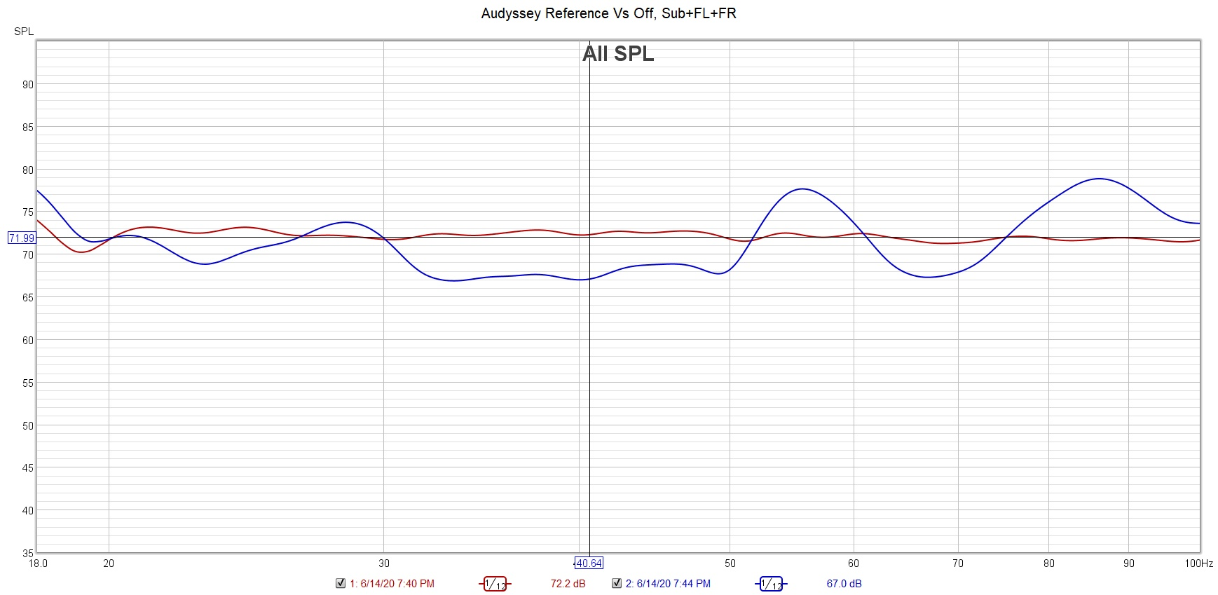

Humps, however, are much easier to deal with. What you have now between 23 and 27 Hz is really not that bad as mentioned before. For the 3rd time I say this, you can leave it alone. If you hadn't used REW, you would have never known it exists right? To take the steps that I, and others have mentioned, is more for fun, theoretical, it may or may not result in any audible improvements to your ears.
Mine is very smooth, at 1/12th smoothing, I am getting less than 1 dB +/-, but I could be just as happy if I had left it alone and just use the one without customizing with the App.

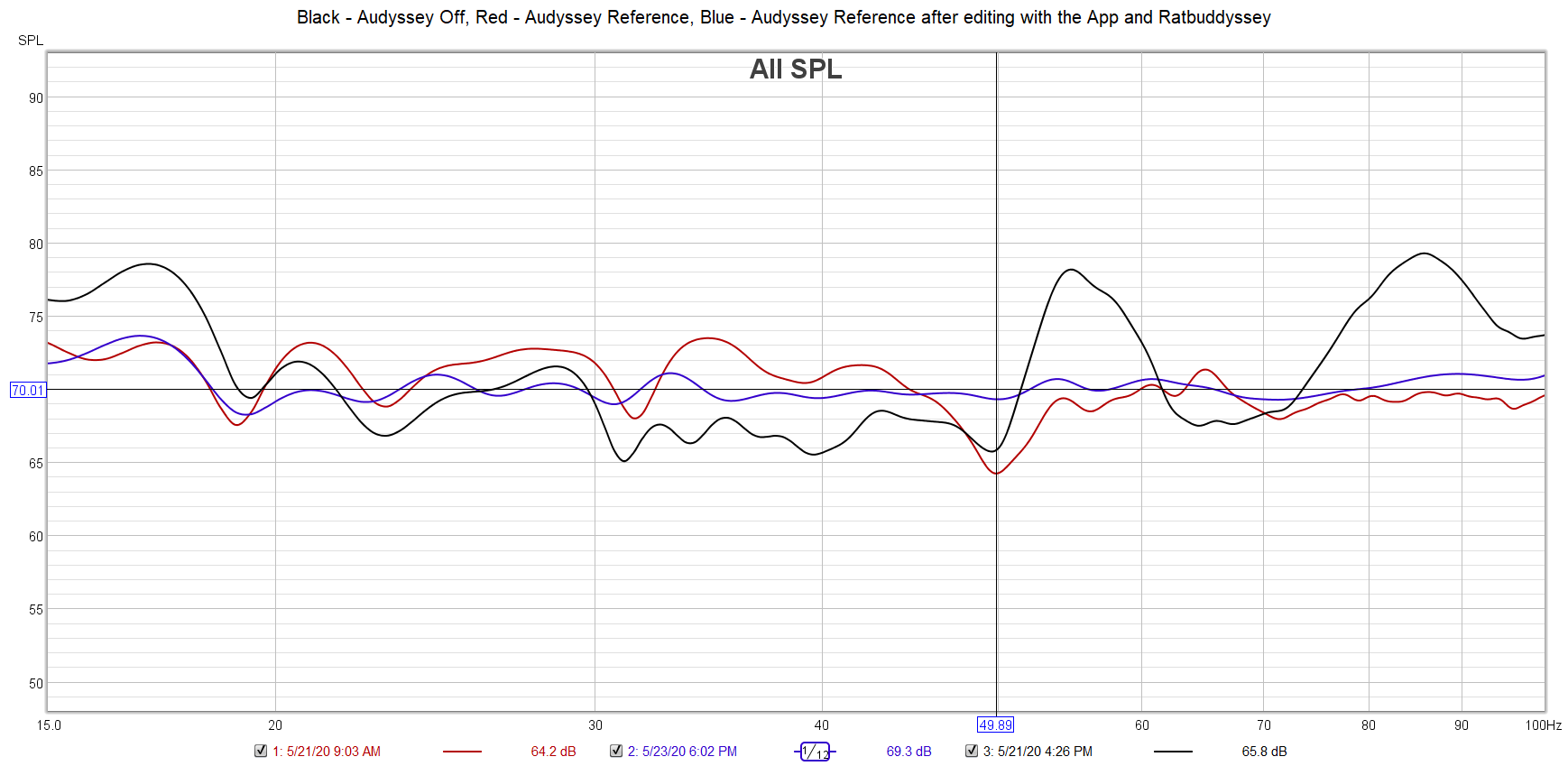

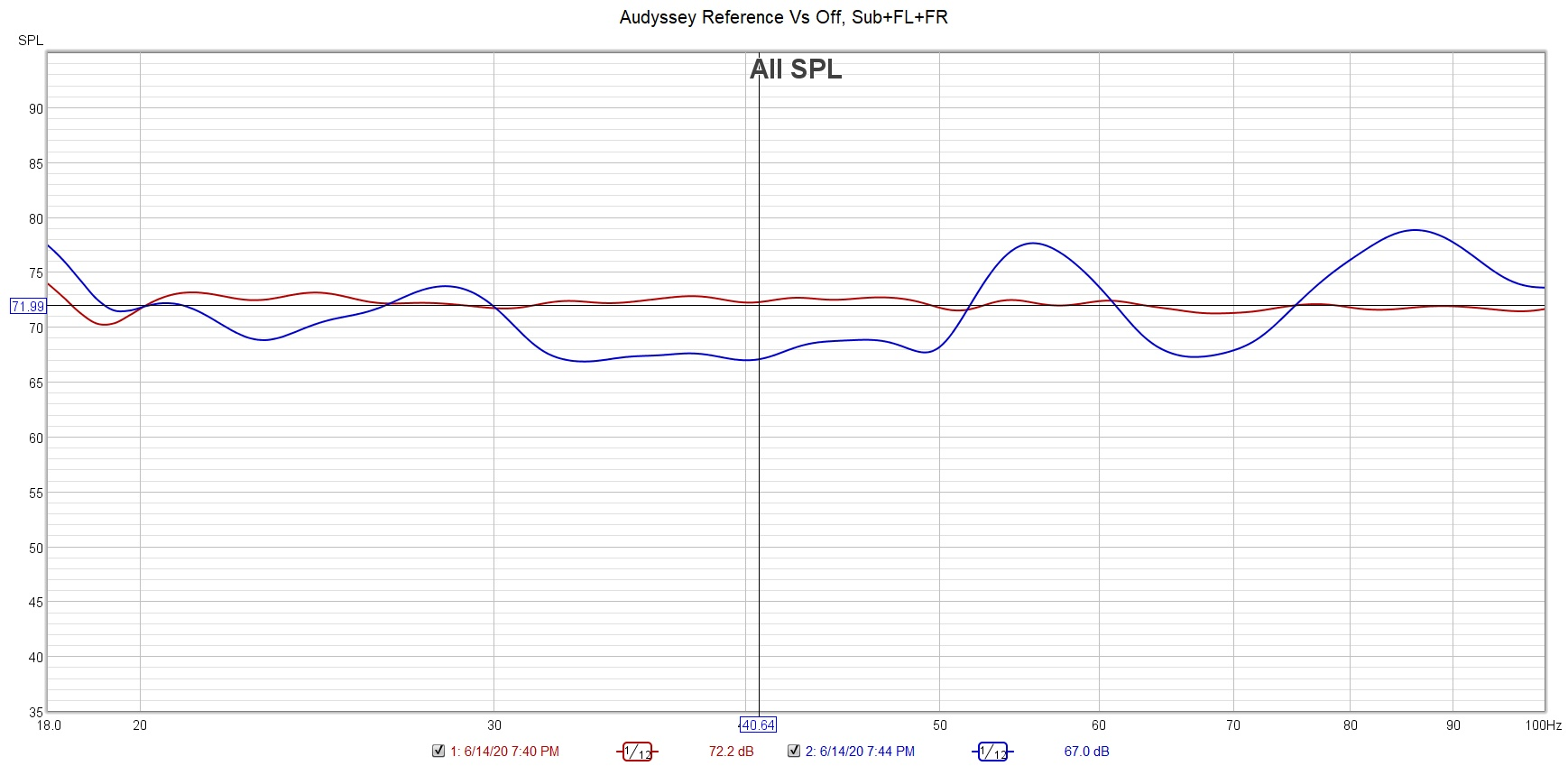

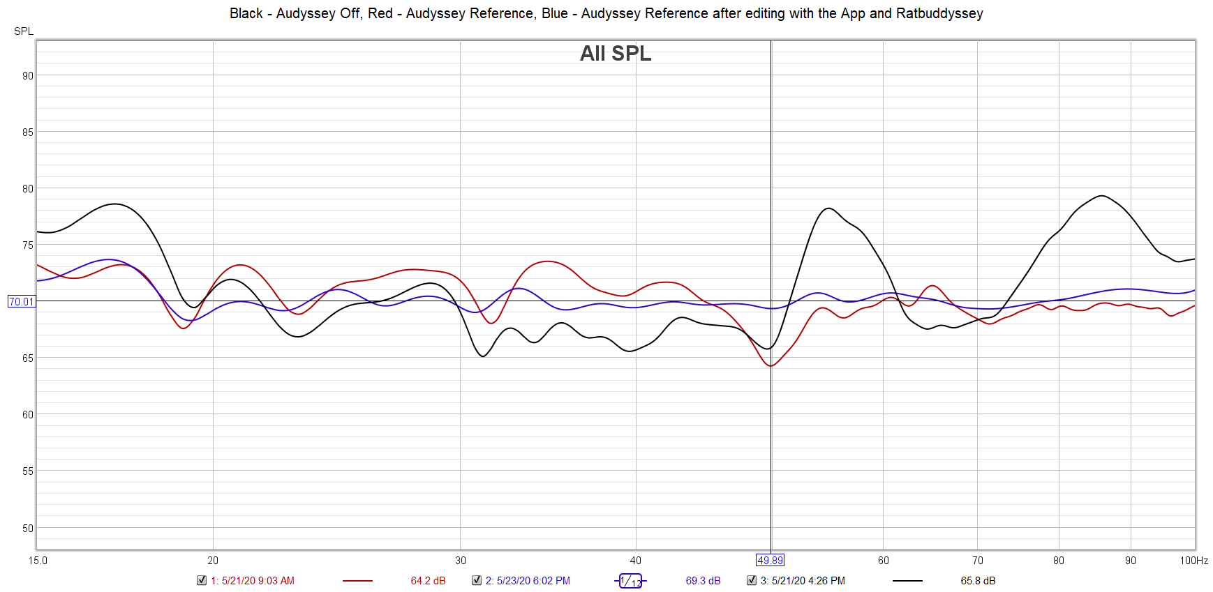

and below is one that compares Audyssey off vs Audyssey Ref before editing vs Audyssey Ref after editing. Those may not be as good as my latest one in use, but I can't find that one, got too many in multiple folders.:D
