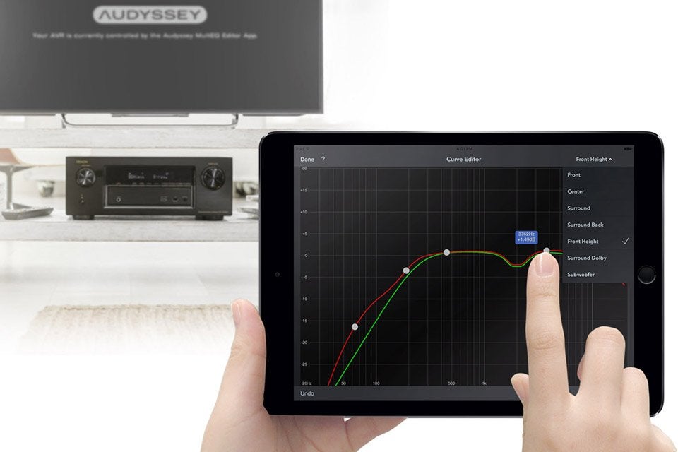

I just ran aud. using the app but I have to go to work so I can’t play around. How do I know the changes I made in app are being used in the avr? When I checked avr, the settings are still the same from when I didn’t use the app.
In the app should midrange compensation be on/off and where should the frequency range be set?

MRC should be off.
When you’re done, you have to send it to the AVR can’t remember the button, lol. It’s been too long since I did it...

There is an upload icon, third from the left, activates a drop down menu, send to av receiver.
turn midrange compensation off. I learned all this yesterday.

Ok thx guys. What about the frequency range, where should I set that? And, any idea why when I run audyssey through app it’s sets my second sub behind my couch at 11.8 ft but when I run audyssey without app it sets that sub at 5.2ft? Should I change the distance

Also the app set my subs volume up front to -7.5 and my rear one at -6.5. Running audyssey without app it’s sets my front subs at -10 and my rear to -10, should I change their volumes?

If I understand correctly, the measuring of LF waves is challenging, thus inconsistent. For example, when starting Audyssey tests, you begin with the Subwoofer SPL screen where you have to try to dial your gain in to about 73dB. Isn't that fun watching the OSD of your Sub SPL jumping all over the place while making that adjustment? :)
I know the Aud mic isn't the best tool in the workshop, but it's a good start.
Getting Audyssey set, with levels and distances is useful. Though I don't have studies to back it up, my XT32 App usage has always seems more consistent from test to test than just using the AVR did. Ultimately, it would be nice to check the timing of delays set by Aud, as this seems to be one of the more misunderstood aspects of dealing with Subwoofer DSP and "Distance" settings. (Consider the general rule of thumb that gets tossed about; that the distance for a Sub could be anywhere from 1/2-again as far to twice the actual distance-to said Sub!)
Some intense critical listening sessions always accompany my playing with Auddyssey. Can I hear a difference? Better/worse? Is that 2K-5K Hz range too bright still? ;) Does the bass sound tight and distinct? (I'm not suggesting I can hear the difference of a msec in delay, but I do know the App dialed in my subs better than just the receiver.)
Regardless, the other comment I wanted to chime in on is the dreaded MRC. I experimented with that early on because my room is pretty bare and those frequencies were definitely strong in my room. I used it On, Off, and even drew in my own version of MRC for a bit using the App. For that, I made the dip shallower and wider: more of a gentle swale only 1.5dB deep rather than a 3dB crater.
I actually found this to be a very pleasing solution to my room for a while until I got better positioning locked in.
Using REW or OmniMic is a definite necessity to take Audyssey to the next level. We've seen time and again the progress friends have made with further dialing in their subs and flattening their FR down below the Schroeder Frequency of their room.
Which brings the last point: setting the Frequency Limit or Curtain for Audyssey correction. When your room transitions from acting as a resonant chamber to more linear performance, that is the Schroeder Frequency. Numbers I've seen tossed about range from 100Hz up to 500Hz. Most commonly, I think it tends to fall between 200-300Hz in most domestic rooms.
I use the before graphs for my Subs and Mains in the Aud App to eyeball the point where the FR starts to naturally even out and set my Curtain there. No need to correct above that point. ;)

Nice post man! So for sure that frequency range needs to be adjusted from where audyssey sets it?

It depends on several things, that's why Ryan did the experiment that he did.. If you don't want to play with it, and with REW/Mic, then it may be safer to just set it to 300 Hz, or just try 300, 500, 600, 1,000 Hz and see if you have a preference. With the App you can save a bunch of curves anyway so it won't take too much time to do such simplified experiment. If you ask Audyssey, they will likely tell you to leave it full range, but I think they are naturally biased. Dirac will likely tell you to experiment but also would encourage you to try full range.

Ok. I watched the video this morning I’m pretty you had linked to me on my 4400 thread with the software designer of audyssey and the other guy with him but I believe the software designer said to keep it where audyssey sets it. I’ll try different adjustments

Btw sorry. When I was looking at the frequency range I was just looking at my front left and forgot I needed to select each speaker to see where range was. It set my sub at 250, so I assume I just go up from there and see what I like? Do I need to adjust my other speakers too or just the subs?
