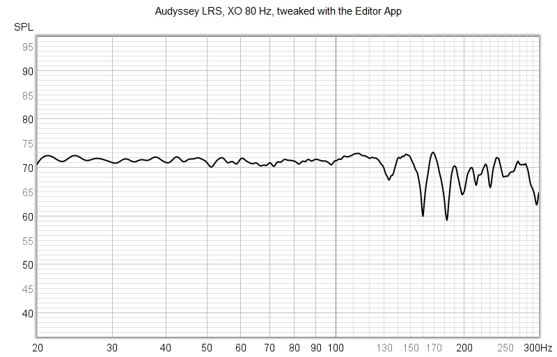

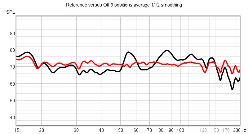

A little bragging, if that's okay..., below are for the front left, right and the two subs running. I would think these are hard to beat by anyone, any system. Dirac Live's could not beat it so far in terms of smoothness from 20-200 Hz, but Dirac did better in impulse response and subjectively more transparent sounding to me.
1/12 th smoothing, mmp only:
9 mic positions average:
I don't disagree, that's why I only show 20 to 200 or 300 Hz, though I typically show LRS, left, right, Subs just to see how they integrate and the effects of different XO points.
Yeah, I just think the subs sound so much better with EQ. :D

I would love to see them once you get organized.
My chart was not as good I think. Without smoothing in 20-200hz region the variation was around 6-7db with 15-40hz having the highest output. Smoothing did not make much difference (maybe 1 dB better). Above 200hz without smoothing I had a lot of micro dips which smoothing eliminated leaving the freqs within 5-7db again. So I am hoping to avoid those micro dips. I am happy with my bass even now
Based on my experience, I would guess that in most typical rectangular shape room like my two rooms, 6-7 dB variation (peak to peak) is easily obtainable it the Editor app is used with Ratbuddyssey or some other paid 3rd UI to reduce the dips and boost minor peaks slightly. The process should take less than an hour, depending on how much trial and error needed, and the time to run REW in between, to see the real efffects.
To achieve 2 dB or less peak to peak, i.e. +/- 1 dB in the 20 to even 150 Hz range, I had to spend many hours over days, not worth it and there is no way I could claim any audible benefits, vs +/- 3 dB peak variation in that range, especially if I put a Harman tilt in the deep bass range.
That's why I believe all those claims about how great RC, whether it's Audyssey, Dirac Live, ARCG or even Trinnov are mainly (say >75%?) based on people's eyes and brains, and/or their measurements such as REW graphs, if the graphs look great, it must sound great!!), not their ears, though I do believe for those who apply RC/EQ full range to 20,000 Hz, audible difference would be real, but in those cases, the users better know what they are doing... On this part (about the >75% brain based, not ears), I bet even @AcuDefTechGuy might agree with me.:)

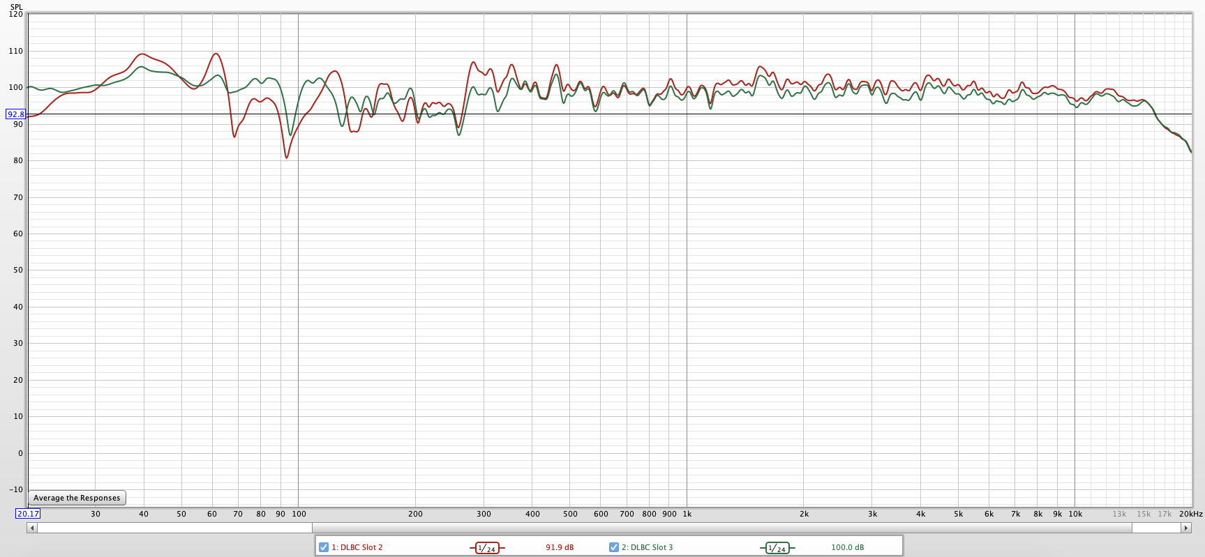

Ok, I was able to get better results (Slot 3) by increasing the crossover on the subwoofer itself to 140 Hz and measuring all 14 points with Dirac, and setting a 90 Hz crossover.
Would you mind share with and without Dirac without any smoothing?

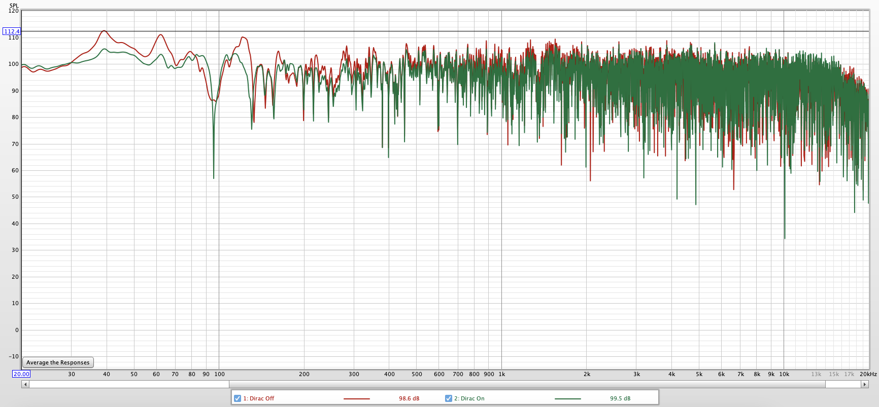

Thank you! Interesting, Dirac reduced some dips but made some others worse. Did you set all speakers to large before calibration?
@PENG, don't you have similar micro dips even with Dirac activated?

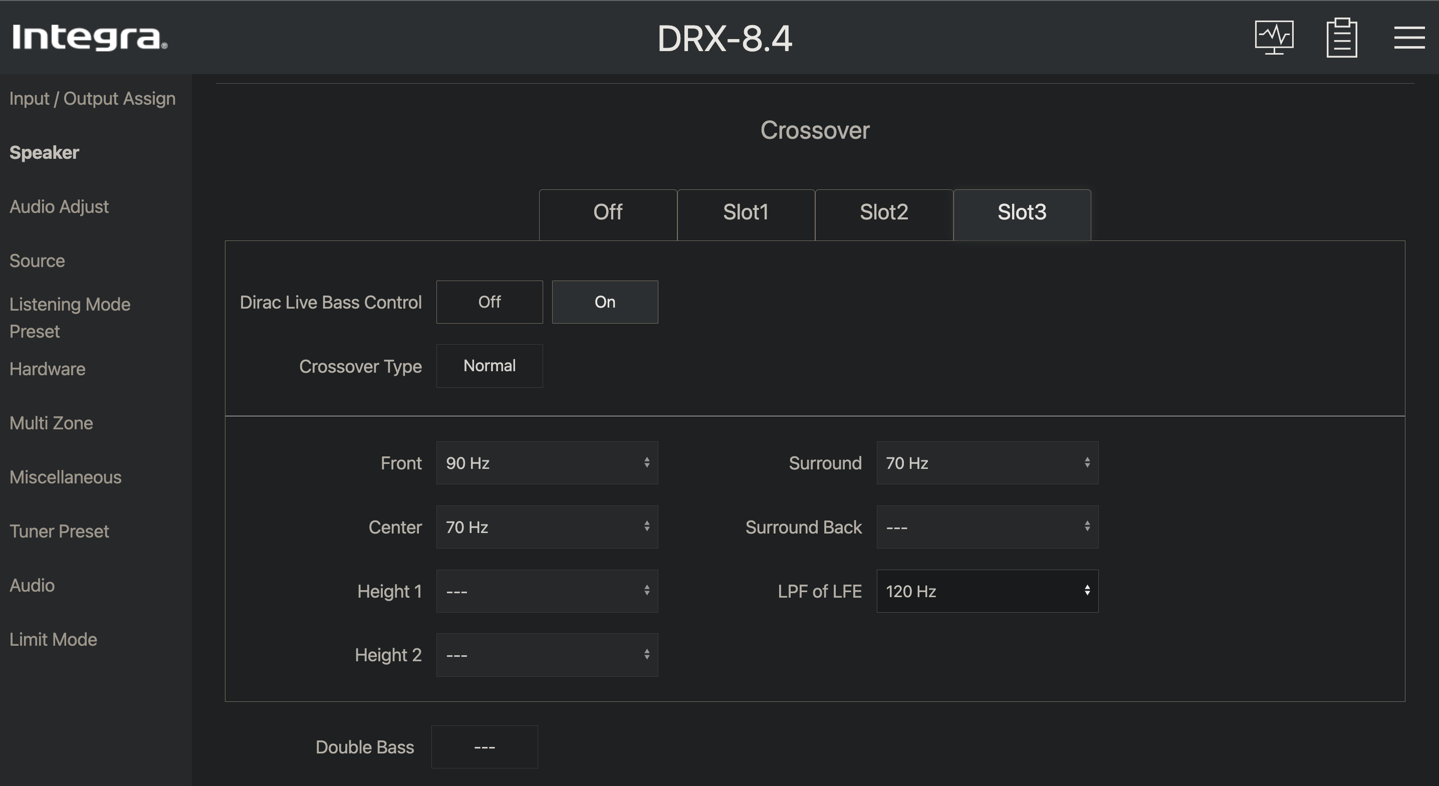

Full Band / Double Bass is not an option when Dirac is enabled:
Did Dirac suggest crossover freqs or you need to set it manually? Your Dirac is within avr so in theory could find the optimal values given it has access to all avr parameters.

Yes, it set the crossovers for each speaker and suggested a 70 Hz crossover for the subwoofer in DLBC Complete. which I changed to 90 Hz.
Yes, but such micro dips don't really do harm to sound quality, according to the experts such as Dr. Toole. In my experience of using Dirac Live PC version, I cannot say conclusively which is better in terms of FR in the 20-200 Hz range. My general impression is that without tweaking with the apps, Audyssey did a little better in handling the major suck outs, but DL seems to do better in terms of overall smoothness, though in the deep bass range, I don't believe anyone can tell a difference even in single blind test.
In the mid and high frequency range, I prefer Dirac as it seems to improve transparency that is easily audible to me, especially on my desktop system.
