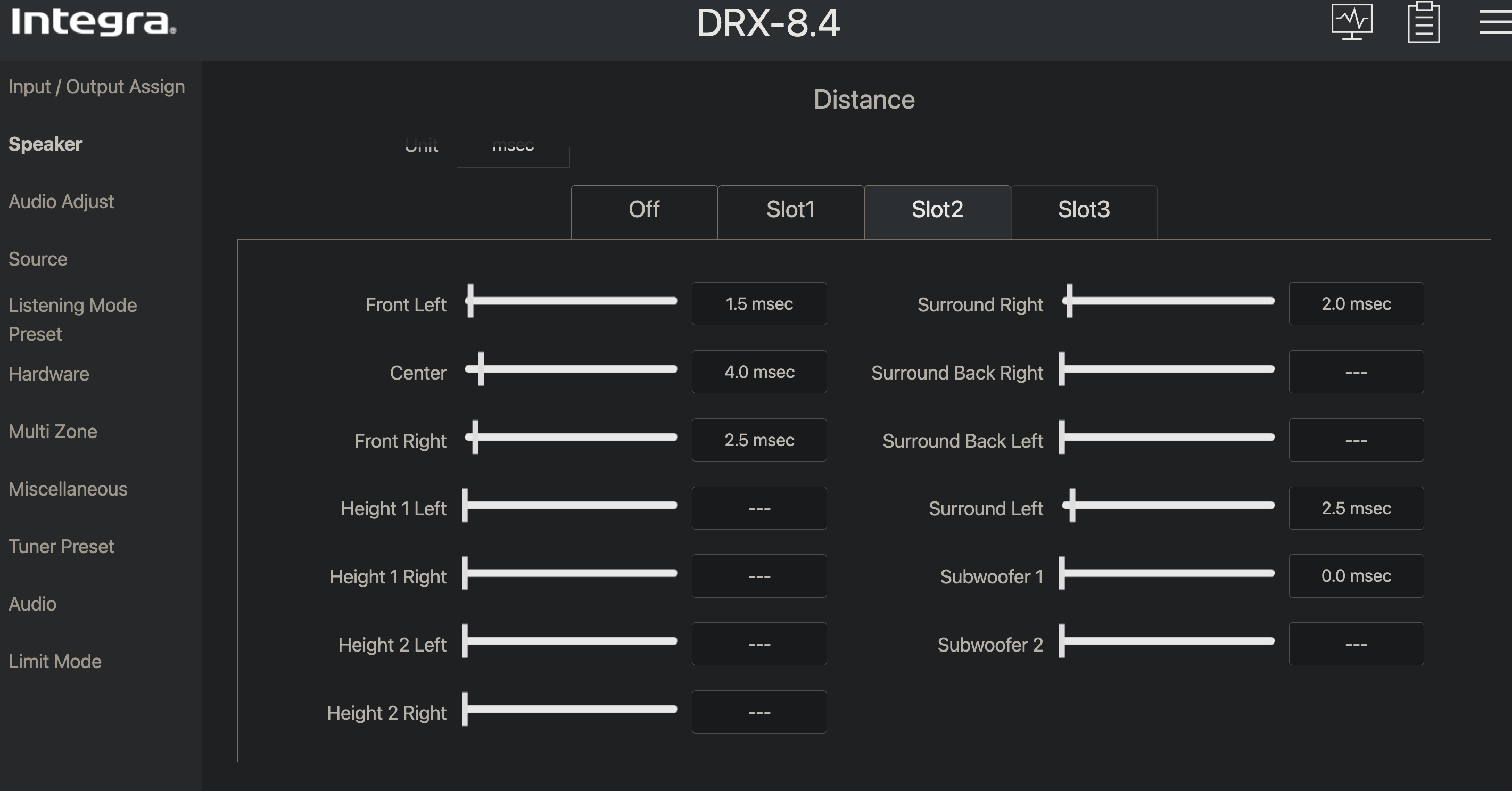

I've already done a calibration with Dirac Live and DLBC, but the first bug I've come across is the 20 ms max channel delay bug, as seen on D+M receivers as well as the RZ-50/DRX-3.4 before it was patched:
At the moment, I have my subwoofer on a wireless adapter due to the construction underway in my living room. Tomorrow AM, I'll find a temporary spot where I can direct wire it in order to get proper channel delays configured. I've opened a ticket with Integra requesting an increase to 50 ms maximum delay, and will do so with Dirac as well.
Once I've got the sub hardwired, I'll take some new REW sweeps and post comparisons between DL and DLBC.

Who am I kidding about "tomorrow"...new channel delays with hardwired SW:
So nice, I always prefer delays vs the confusing "distances".

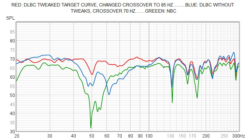

It depends on the results. In my case, 90 Hz works better than 80 Hz. I haven't touched it for a long time, so I don't remember the upmix vs complete thing. My experience with dlbc was in beta testing only, the PC standalone version.

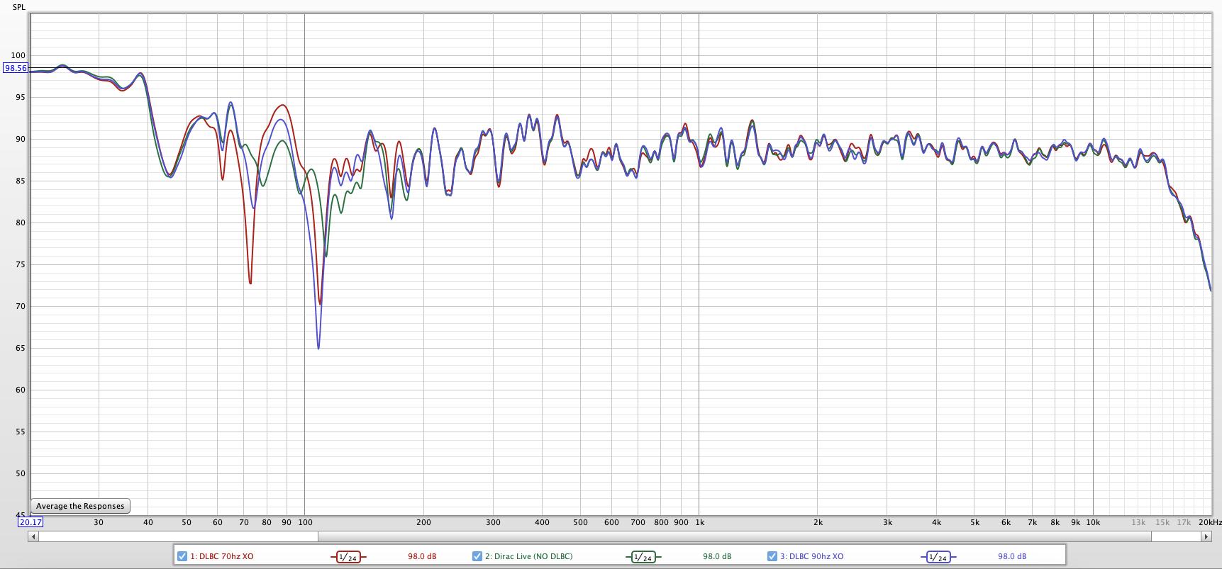

Still dialing things in. I tried both 70 and 90 Hz XO. Interestingly enough, I seem to be getting better results with DLBC off at those cross over points. o_O

I posted mine on ASR, it was no pretty with the default crossover. At the time, I thought may be that's because of the beta version but it looks like you have similar finding. That's why I am skeptical with ART, what looks good on paper, may not look at good for real world use as it depends on all kinds of things.
Dirac Live DLBC comparisons, no smoothing:
I'll play around with it a bit more this afternoon to see if I can tweak the crossover better -- I'm also curious to try running my mains at full range with Double Bass.

Would you like to post it and compare? Keep in mind the one I posted were with no smoothing. Many would use 1/6 ore even 1/3 smoothing and if I did that it would look like a flat line.
