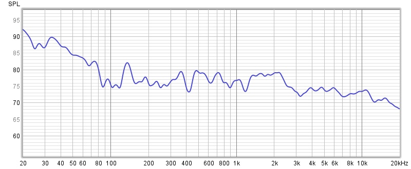

Sorry, silly question, but is this post-calibration with Dirac Live and DLBC? No more EQ will be applied? Because it looks... uneven :)
ban25
ban25
Correct, this is post EQ. Note that this is actually measured response in room versus the "predicted" curves most Room EQ software will show you.
hometheaterworld
Hmm, thanks. I guess I have to lower my expectations on what Dirac can achieve in a bad room (like mine). Here is my current center+subs measurement in my room, no speaker EQ/calibration applied, only to the subs up to 80 Hz with a MiniDSP. Do you think I would benefit from DLBC, or should I just get a receiver that supports a limited range Dirac Live to EQ my LCR speakers up to 500 Hz?
ban25
ban25
