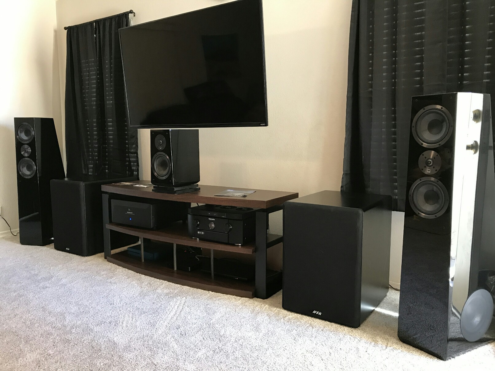

Picked up the surrounds last night and hooked them up temporarily. Put them 6 ft off the floor (70" to the tweeter to be exact, which is the same height as my front channel tweeters), and they are spaced 12'-6" apart, which is as far as I could practically space them. I haven't run Audyssey yet, but things are sounding pretty good. Here are a couple pics of my living room. It should become obvious why floor standers just wouldn't work in my space. Added benefit of the bipolar SR9040s is the outward facing speakers face into my dining room and my foyer, which I like. Music while you're eating and in your face when you enter the front door :D

Pardon my laziness, but someone made a comment about perhaps needing a second sub to prevent localization. I'm finding the need to turn the gain up on my sub to get the power I want, which is having a localizing effect. Is the purpose of getting a second sub so the pair collectively give me the bass I want but split the bass between the two so neither is localized? If so, makes sense. If I got a second sub, would it need to be placed more or less opposite the existing one?

I don’t remember what you are using, but judging by the photos you have some pretty serious open room volume. Multiple subs will make a more even bass response in the space. The size of the sub and it’s output should match the space. (Read the Bassaholics info here at AH as a good primer.)
In short, if your sub is slightly underpowered for the space and you are running it hot to compensate, I would expect you might be able to start noticing it more.
Adding subs: they should ideally be matching subs, and better would be matching subs well suited to the space.
There is a lot of opinion and personal preference for placement. I subscribe to the school of using the sub crawl to find the best acoustic spots in the room, preferably asymmetric placement of multiple subs, then backing those up with measurements.
Others like symmetry and front wall loading, corner loading, 1/4 wall, 1/2 wall... etc. I prefer my subs be away from my mains.
Many ways to go about it. In the end, learning about your rooms acoustics and working with them will get you further. :)

Audyssey actually attenuates the sub gain a few dB, so apparently it is adequate for the space. I think the primary reason is due to the LP being against a wall and under a flat ceiling. The sounds waves resonate in that area. It isn't nearly as loud if I'm standing in the center of the room where the ceiling is vaulted. The one sub is plenty loud enough, but like I said, I am able to localize it when I want to increase the gain for certain content.

I saw your pics an have had some conversations with you about that sub. More than one of us told you it's too small. It is not a big enough sub for your space. Period.
Yes a second one will help, but this.
Tells me another story.

Sorry, I misspoke. What I meant to say is sometimes I want more bass during certain programming, and the sub becomes localized when I turn it up past a certain level (understandably). So I was basically asking if getting a second sub would alleviate this problem.
