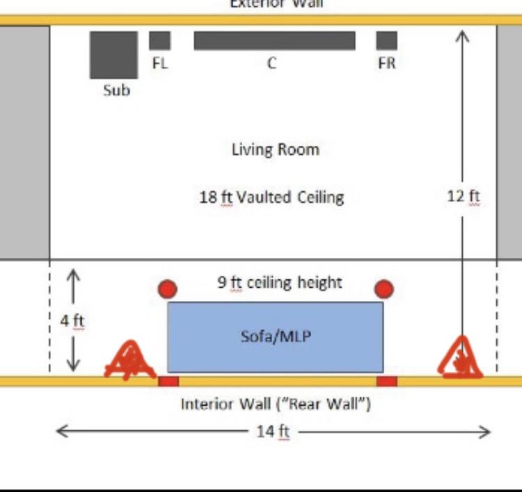

I'm only interested in in-wall speakers. The only way I would go with on-wall is if they were the downward-firing type that fit in the corner of the wall/ceiling. Definitely not doing stands.
I get the cosmetic part of the inwall vs on mounted on wall. That creates a tough spot to get an ideal surround sound system.
I've seen a 5.1 like this (with surrounds in the rear)...it's not ideal as noted, so don't spend a ton on inwalls, but it will work...positioning and tweeters that you can adjust make a big difference. I would do inwall long before I would inceiling surrounds.

Those are nice, but I won't be able to aim them toward the LP. That is the thing I'm hung up on. Maybe go with one of the bipole speakers I linked to and disconnect the outward facing drivers?

What about the smallest bipoles you can find?Mount them with keyhole slots. Done. Don’t worry about the outward firing drivers. They might even help! The inward ones should hit the LP just how you want.

It's not that I dislike seeing speakers, it's the layout of the my home. The front door is directly to the right of the sofa, so I don't want people seeing speakers, wires, brackets hanging off the wall when they walk in. At least the trapezoidal-shaped speakers have more of a subtle transition from wall to speaker. Just wish they were white.
I just had a good idea (I think)...I could build recessed pockets in the wall to house an angled speaker such as the DefTech SR9040. That would give me the angle I need towards the LP AND the clean recessed look of an in-wall speaker (although the pocket would be open).

Like this (SR9040s are 5.38" deep, so the bottom shelf would have to protrude from the wall about an inch, which is fine. I would put a piece of door/window casing along the bottom to dress it up...

Yup. That's what I had in mind. They're at least not flush with the wall and you might get some side-surround effects. You can wire them in different ways too if you want to experiment. Make sure you do a little homework first before you start spiderwebbing all those binding posts together tho.

One thing I can see being a potential issue is the sides of the pockets reflecting the sound waves. I'd have to make the pockets considerably wider than the speaker to avoid too much of this. Still could work though I think.
