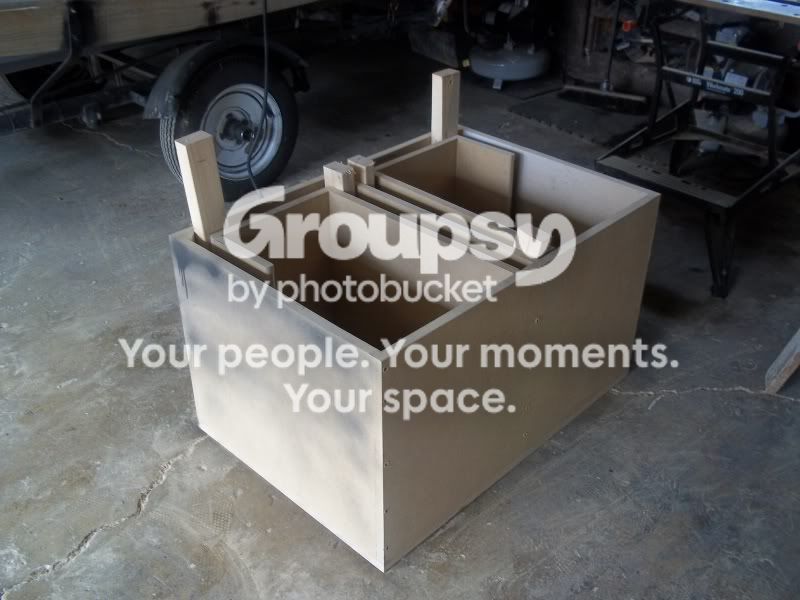

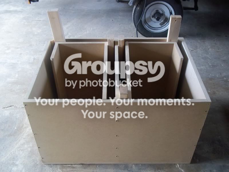

IS IT RIGHT SO FAR GUYS? I WASNT SURE HOW LONG TO MAKE THAT SHORT PIECE ON THE VENT.. I HAVE EXTRA WOOD SO PLEASE LET ME KNOW ANYTHING THAT LOOKS WRONG AND I WILL FIX IT ACCORDINGLY
PLEASE LET ME KNOW ASAP BCUZ AS SOON AS THE SUBS COME IN MONDAY IM GOIN TO FINISH SO IF THERES ANYTHING WRONG I WANNA FIX IT TODAY. ALSO WHERE SHOULD I PUT THERE BLACK N RED SPEAKER TERMINALS? I BOUGHT A FEW OF THEM.. I WAS THINKING ON TOP OR BOTTOM SO IT DOESNT INTERFERE WITH THE VENT? LET ME KNO GUYSS
THANKS L
Nice work so far. The total length of the vent should be 39 inches down the center line of the vent from the point it exits the enclosure to the very end of the "J" as someone mentioned.
From my calculation without drawing it out, I estimated that piece to be about 1" in length using a center line measurement when I was coming up with the design. Using a piece of string you can confirm but that should be correct.
I am not sure if the vent pieces are in place yet, but if not just ensure that the vent width of 1.625" remains uniform.
I assume this is being constructed with wood glue & screws? Very good if you are. Remember that when bracing is added to keep it far enough away from the vent opening internally (at least 3" or more).
Again, nice work! Be sure to let us know how it sounds and post your pics!! I am very confident you will be quite pleased, especially considering what you are replacing! The best part about it is you can brag about the minimal investment you made and that you did it your self. With a little help of course ;)

ok thanks guys anunaki i forgot to mention.. my dad and i had one problem and he had to makke the distance between the wheel wells 34in instead of 35in in the original.. i didnt glue anything in the inside yet.. so it can be moved. i will make it right. but do i need to change anything not that the wheel well distance is 34in?? please let me know asap.. the subs come tomorrow.. i will install wen i get off work around 3-4pm.. mayb a little later.. if i can i will post a video of how they sound.. but please let me know if anything changes not that it is 34in between the wheel wells.. and anunaki where do you suggest i put the terminal cups? and yes i did use both wood glue and screws.. should i caulk it? or will it make a difference??? please get back to me asappp!!
thanks again
L
That is a rather important detail to leave out!
This drops your net internal volume by .22ft^3 or so and raises the tuning frequency to 26.79hz. It further lessens the very low end response but will not be too significant. Just ensure to keep the vent to 39.0" in net length. Going any longer at this point will only further lower the net effective volume as the gross volume has now already been decided/constructed.
Consider yourself lucky on this one making a change like that. With some woofers this would have DRASTICALLY changed the entire response of the woofer.
This also means that the end piece of your vent, at the end of the "J" will increase in length as the center section has now been reduced by an additional .5". Without figuring it all out it will most likely increase by .5" but I recommend measuring first before making your final cuts.

ok well the vent right now is 41in bcuz we didnt know where to take off from.. should we take more off the long piece?
No.
The first part of that vent is the width and height. The height is established by the height of your box so that is set. Now you must maintain the 1-5/8" width. The length of that long piece controls that number at the middle piece. The length of the short end of the 'J' controls the length of the port and that is now what you have to determine by measuring down the center of the vent which is a line 13/16" (half of 1-5/8") away from your outside wall and dividing wall (on the inside of the box) starting at the outside of your box.
Edited to correct a reading error on my part and for clarification.
Thanks Alex. This is correct. The end of the J needs to be shortened. I highly recommend measuring this down the center line of the vent.

ok we took off from the short piece and it is all good now. but i was confused on what you said about the height? is the height as tall as the box or is it smaller inside of there? what should the height of the vents be? btw the subs came in today. it will all be built by tomorrow afternoon i will post pix around noon chicago time. maybe a little later.. but let me know how high the vent walls should be and also where do you suggest i put the terminal cups for the speaker wire?? bottom? top? also.. the subs arent going to be connected together in the inside are they? they both have seperate terminals and they both will seperatly be put into the amp right??
