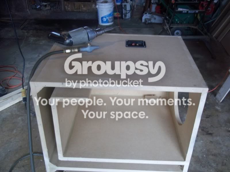

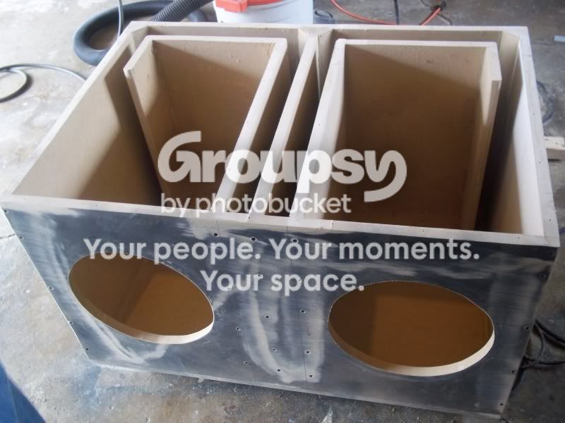

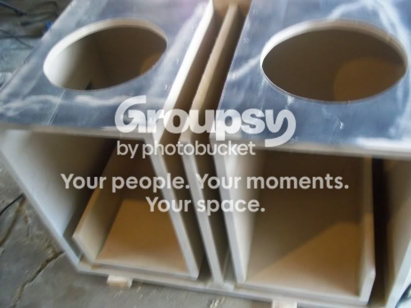

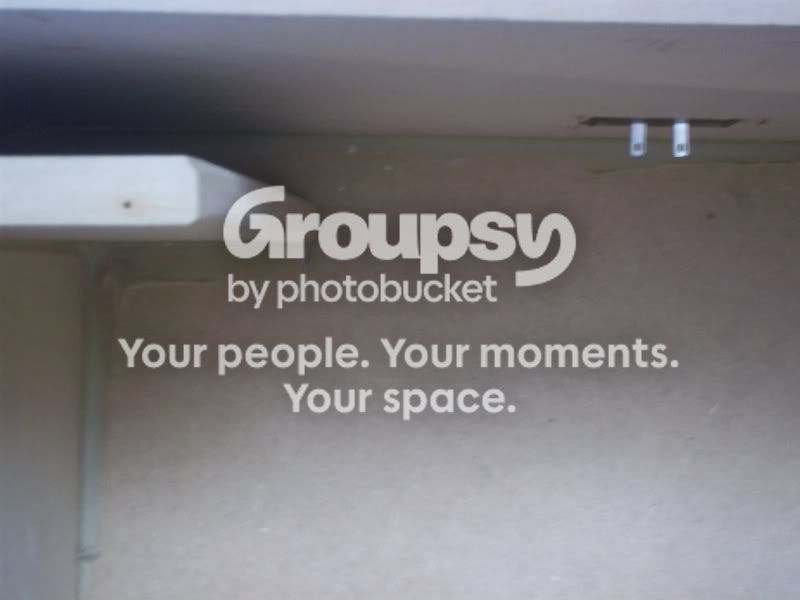

ok im confused about one more thing.. is the vent cut completely open on the front wall? if you look at the picture yu mite understand what i mean.. but is the front wall cut completely up and down for both vents? or is there a half inch or inch lip on it? do you know what i mean guys? its hard to explain... ????
so basically...
01'1 I 1'10 with the I being the common wall.. and the 0s being subs n 1s being each wall of the vent im wondering if where the apostrophe is (the little mark between the 1s) if that needs to be cut all the way to the top piece of wood or if it comes down a little like the apostrophe does? the same with the bottom? if it does come down from the top n go up a little from the bottom inside the vents then let me know how to make it and the size please.. we never went over that..
please let me know asap i will be getting started tomorrow morning!

The vent opening is the same height as the internal enclosure wall, which is 18.5 inches. The vent length was the only item of concern but it sounds like you have addressed this.
As for the terminal cups, that is up to you. The sides make the most sense at this point. i personally never use terminal cups, but rather binding posts such as these here.

ok so that front wall for the vent opening will be cut completely up and down? so there will be 4 cuts down the middle of the front wall completely upside down right? i was goin to go wit the terminal cups on the side but i thought it mite block the vent becuz they will be indented in the box..
As long as the cups are 3" or more away from the internal vent opening you will be fine.
I am not sure what you mean by "completely upside down" but I think you understand what I mean.

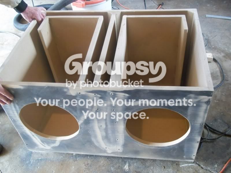

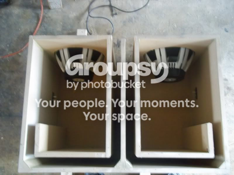

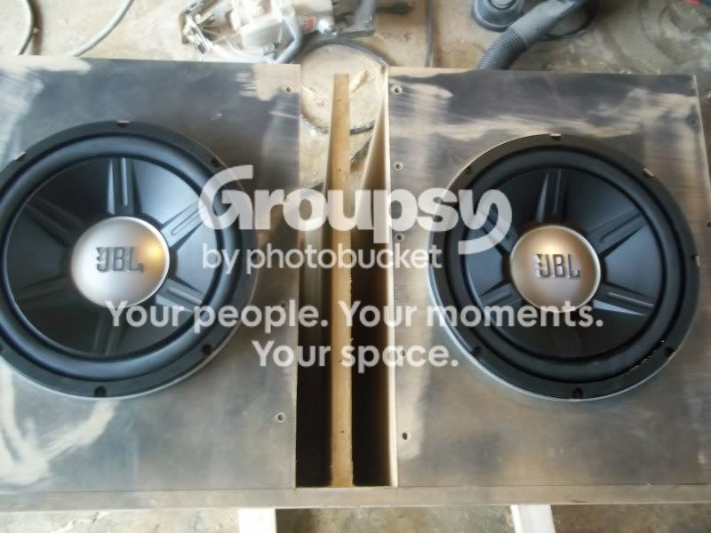

ok im about to post the pix now. im trying to bring them from an sd card but cant locate it on my work computer.. so i did all that then. but i built everything and honestly there is not too much of a difference from the speakers i had in there before? i still have to tighten a few more screws but honestly i dont think this feels like its pumping out twice as many watts as it was before. and i can barely feel any air AT ALL coming out of the vents.. its a slight breeze actually.. barely anything.. around 2 or 230 chicago time im going to finish screwing everything together.. there is a few minor cracks in the top bcuz i dont want to glue that since i mite be taking it on and off to paint and such.. so there shows little openings in the wood but all i have to do is tighten them down.. barely any air is coming out of them.. i didnt tighten all the way but i dont think that would make that much of a difference i would think it would still pump out a good amount of air out the vents bcuz i felt around the box and there was only a little air coming out of the cracks.. so i dont know guys, what do you think? bcuz right now it doesnt seem lik it hits very much harder then those crappy duals i just sold for 120 yesterday..? but just let me know if there is anything i did wrong when i show you the pix..

As for the box leaking air, you can't just slap a box together. As mentioned within the thread, the wood needs to be glued together. Also, each internal seem needs to be caulked. Damage to the woofers will occur if these steps are not taken.
